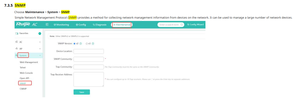

Hello Ghali, the steps to configure SNMP can be founded in following configuration guide for controller
https://www.ruijienetworks.com/support/documents/slide_rg-wlan-series-access-controllers-ac-rgos11-9-6-w5-web-based-configuration-guide/?page=html&keyworks=snmp#_Toc184721555

Hello TAC-Saul,
The setting you mentioned is only valid for the controller. The real question is how to activate snmp on APs operating in Fit mode?
