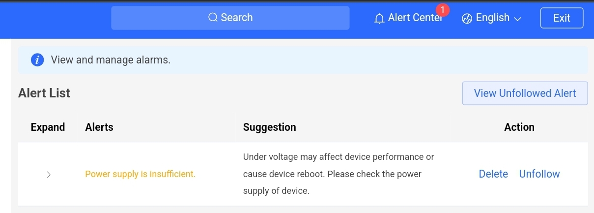

What is compatible PoE adapter model for RG-RAP62-OD?

Salem Mohammed replied at 2025-3-2 03:03
I'm using RG-PoE-AT30 now
So why do I get this warning if I am using the correct adapter?
hi, sir.
good day
You can try changing the poe mode of the ap
best regards
Alan

Hello Salem,
The PoE port from RAP62-OD supports 802.3at
The injector compatible is the RG-PoE-AT30
Regards!

TAC-Saul replied at 2025-3-1 06:07
Hello Salem,
0 2025-3-3 04:39:13 View all replies
Thank you it's solved after I changeing power mode and energy saving.
