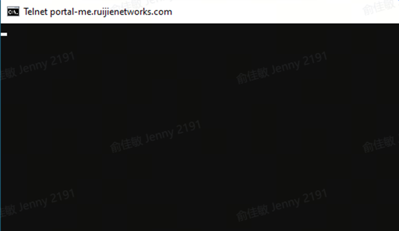

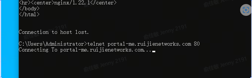

  • Check the network between the client and the portal server
If the user fails to access the portal server, check the network or portal server. You can run telnet +portal domain name 80 command to check further check the network connectivity with the portal server. If the port is reachable, can page can be redirected normally.
