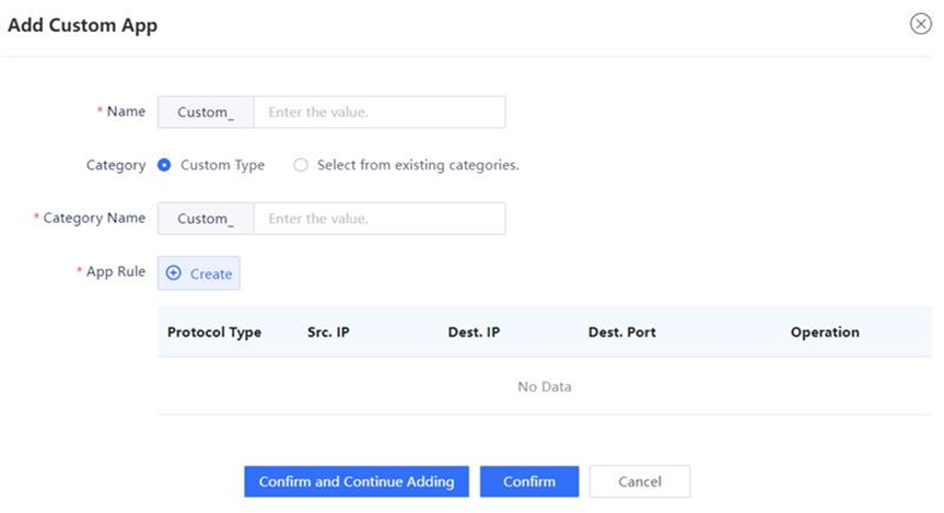

The device provides common application information.You can customize application information as needed to enhance the applicationidentification capability of the device.
Procedure

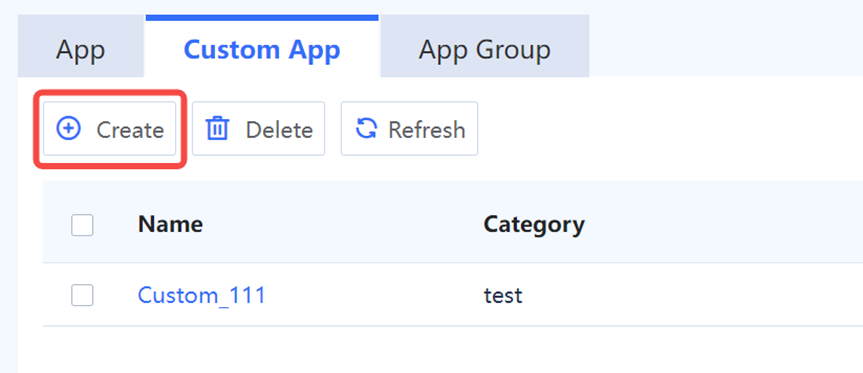

(1)  Choose Object > App > Custom App.
(2)  Click Create.

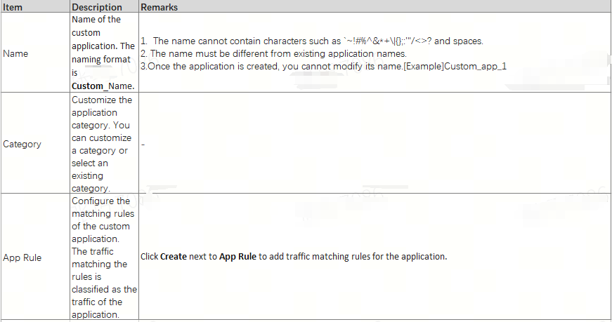

(3) Configure the parameters for the custom application.
(4)  Click Confirm. To add more customapplications, click Confirm and Continue Adding.
