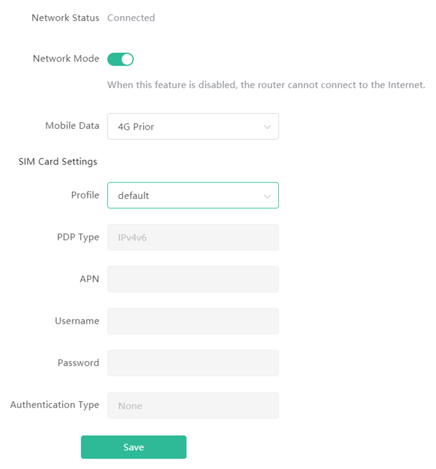

Note:
This function is only supported on the RG-EW300T router in 3G/4G Router Mode, and is not supported on other models.
Configuration:
Mobile Phone View: Choose More > Switch to PCview > More > Basics > Network Access > Network Access.
PC View: Choose More > Basics > NetworkAccess > Network Access.
You can view the network connection status, and configure the network mode, mobile data type, and SIM card settings. To ensure successful access to the mobile network, contact your ISP to obtain SIM cardinformation.
Caution:
When Network Mode is disabled, the router cannot access the network.
Meanings of parameters:
1) Mobile Data
Mobile data refers to the mobile data service, which is data connection service provided through a mobile network (such as 3G,4G, and 4G networks). You can maintain Internet connection in places where Wi-Fi is unavailable.
2) Profile
A profile is used to store parameters required forconnecting to a mobile network, such as the APN, username, and password. After a profile is selected, the APN, username, password, and other parameters are automatically populated.
3) PDP Type
The PDP type indicates the protocol type used to establish data connection on a mobile network. On 3G and 4G networks, common PDP types include IPv4 and IPv6, indicating that IPv4 and IPv6 protocols are used for data transmission, respectively.
4) APN
APN, short for Access Point Name, is the access point name that needs to be configured for the router to connect to a mobile network.
APN specifies the network accessed by the router when it connects to a mobile network. Different operators or ISPs may have different APNs.
5) User name and Password
The username and password are used for authentication when the router connects to the mobile network.
The username and password are used for verifying the identity of the router by the ISP in order to obtain network access permissions.
6) Authentication Type
An authentication type refers to the authentication mode used when the router connects to the mobile network. Common authentication modes include Password Authentication Protocol (PAP) and Challenge-HandshakeAuthentication Protocol (CHAP).
These authentication modes are used to ensuresecure communication between the router and the mobile network and to preventunauthorized access.
