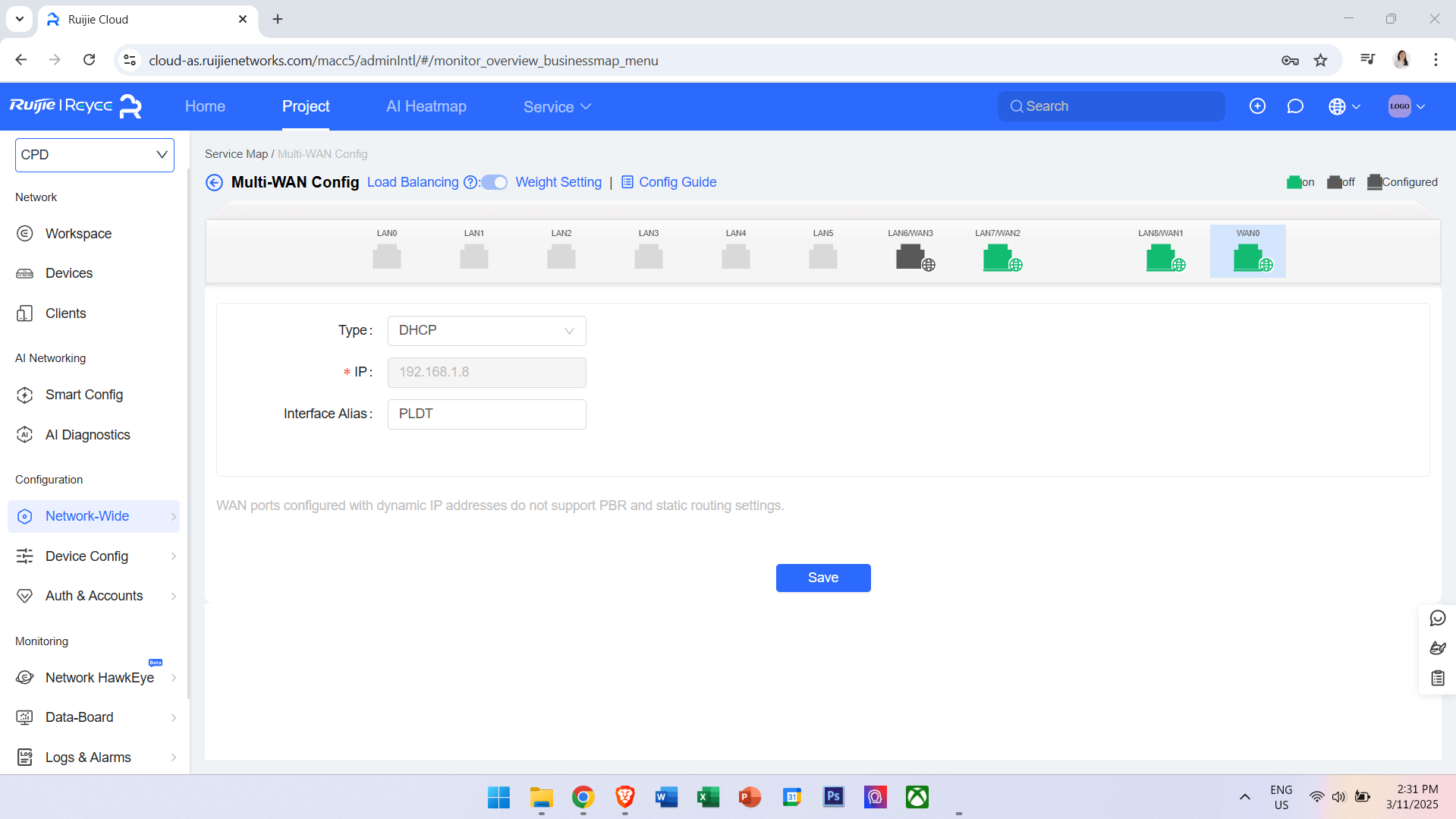

I have 3 different ISP that is connected in the rujie router, is it possible that I can configure this to have 1 default gateway so that we can see the devices that is connected?

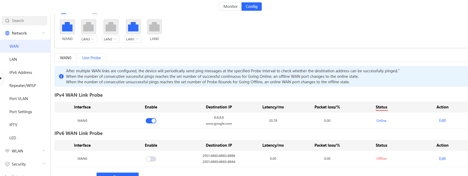

Dear customer,
May I ask if you need to view the connection status of the WAN ports? If that is the case, you can view the WAN port status in the lin probe page.

Hello, I think we have different dashboard in accessing the router.

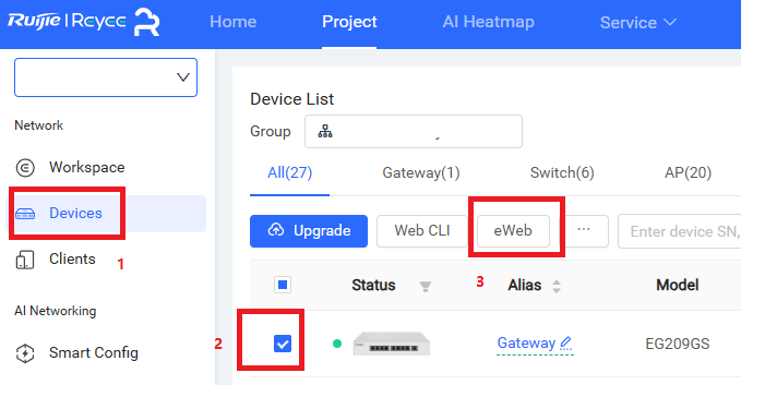

Dear customer,
The WAN port status we mentioned can be check in the eweb of the device. Here is a screenshot of how you can access it.

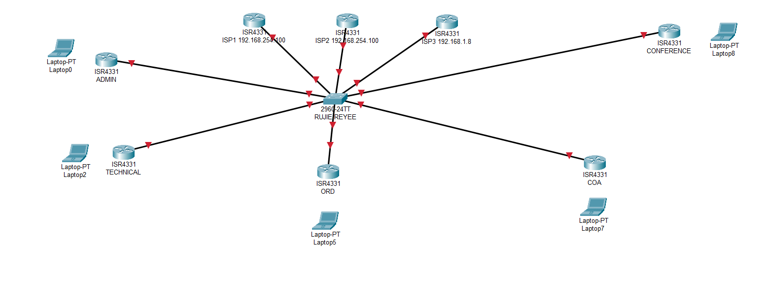

Is it possible that we can configure to be like this?
