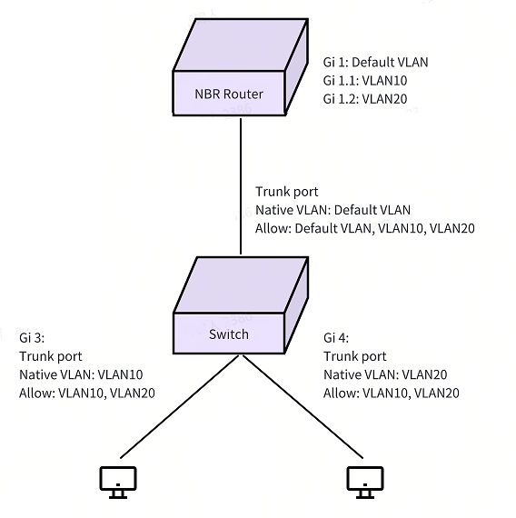

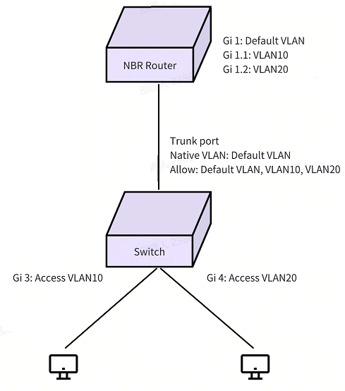

Dear customer,
From the description, I gather your network is configured like the following one. Is it correct?
To allow the communication between the 2 VLAN, you can configure the port 3 and port 4 on the switch like the following.
