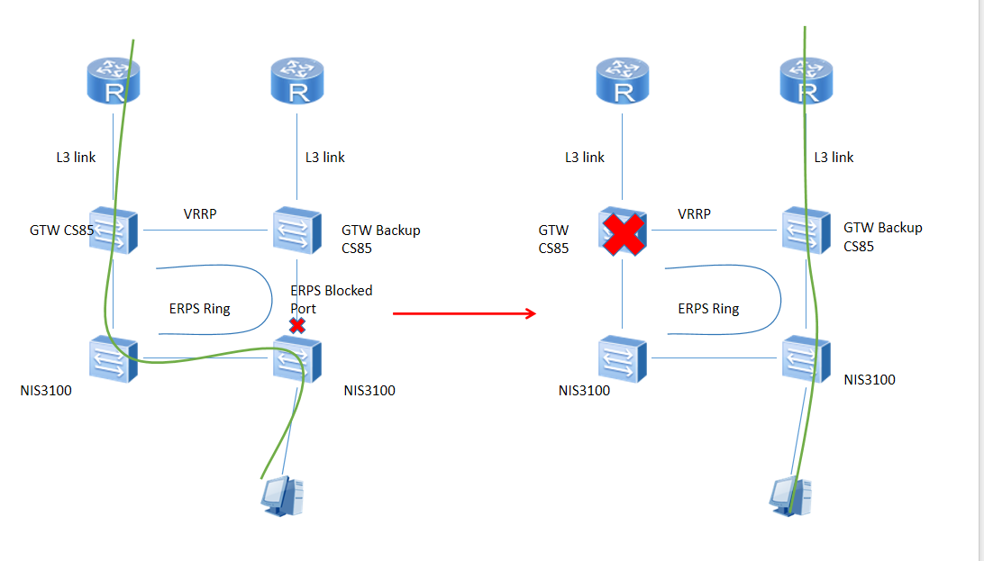

When we are deploy a networking scenario which requires High-Redundancy, we can use ERPS protocol. By the same time, the customer may also need Gateway Redundancy, which requires VRRP.

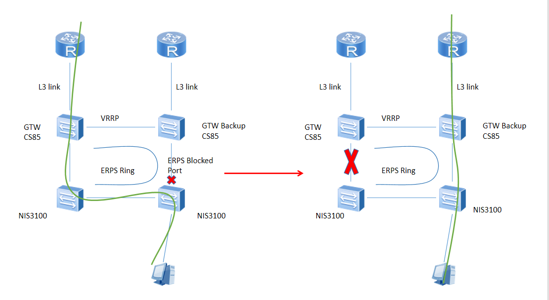

In the following topology, we can check that we have VRRP+ERPS, When we have a single point of failure, the traffic will switch to redundant route, when we have a GTW failure, the traffic will also switch to the redundant link and in the meantime we have a GTW switchover.
Switchover process
1. For normal situation, the traffic will be forwarded through Active(left) GTW
2. When the link failure occurs, the traffic will switchover to redundant link
3. For the single point device failure, we can also active the redundant link
4. If the GTW is failing, the traffic will switchover to redundant link and to backup GTW.

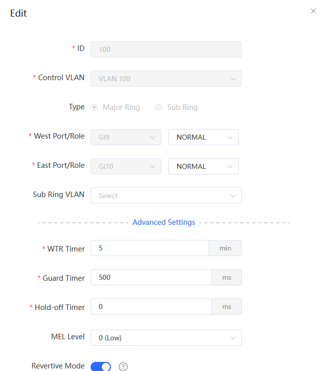

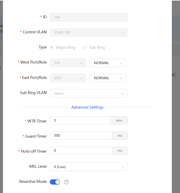

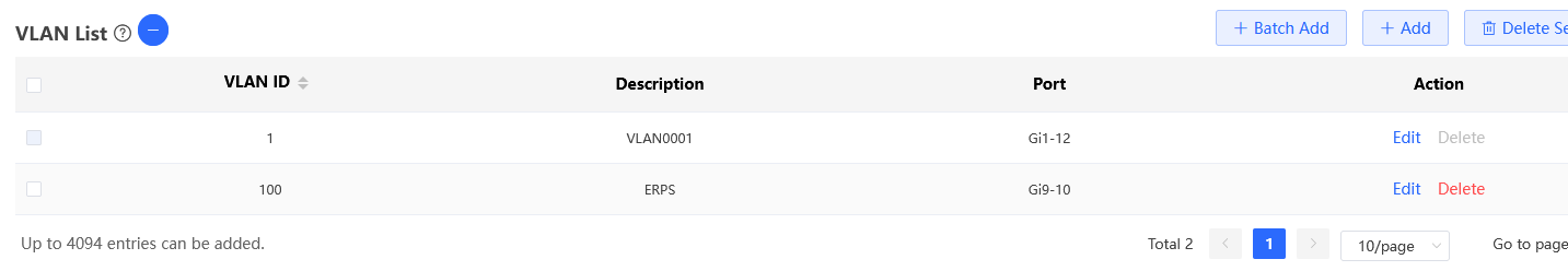

2. Configuration on Both NIS3100
VLAN configuration:
NIS 1:
NIS2:
Note: the MEL Level on NIS switches should be configure to 0

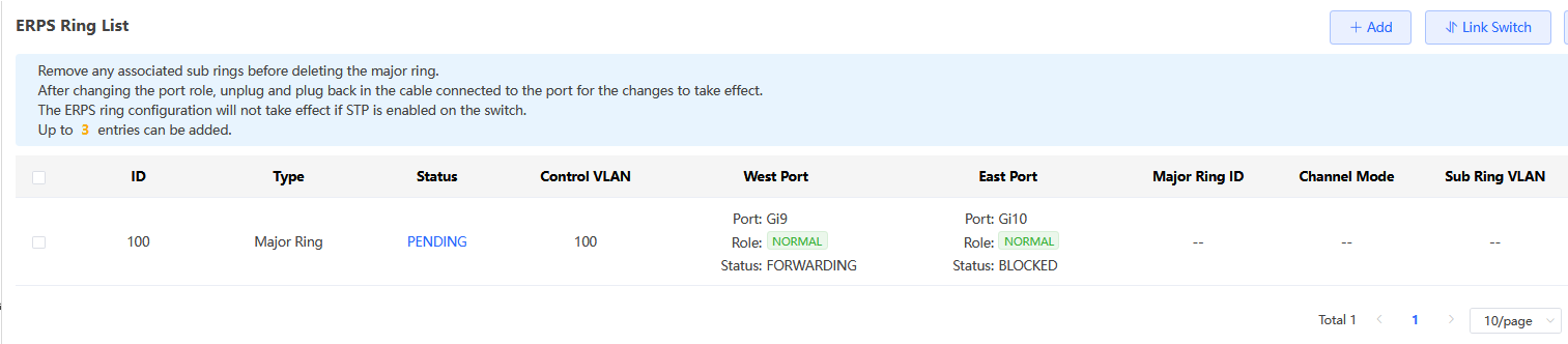

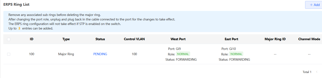

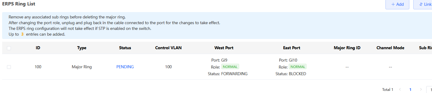

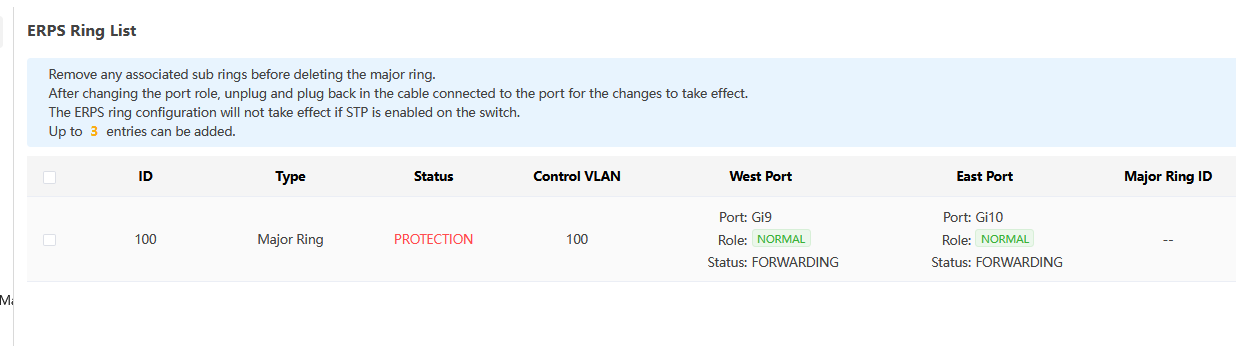

After configuration, the ERPS should be well negotiated:

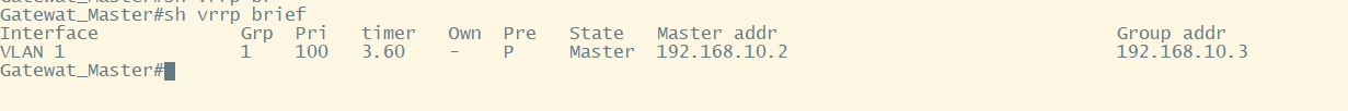

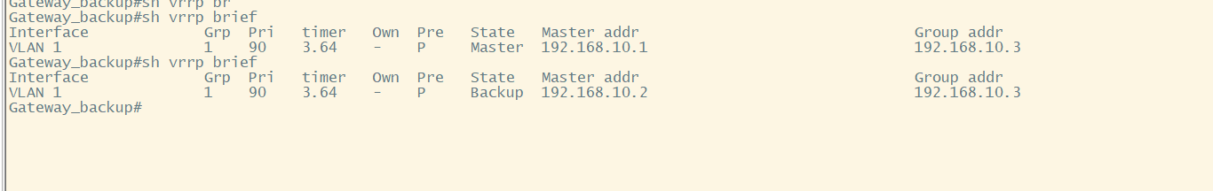

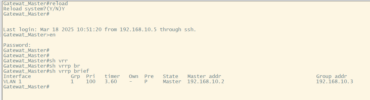

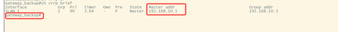

we also check the negotiation of VRRP:
Master:
backup:

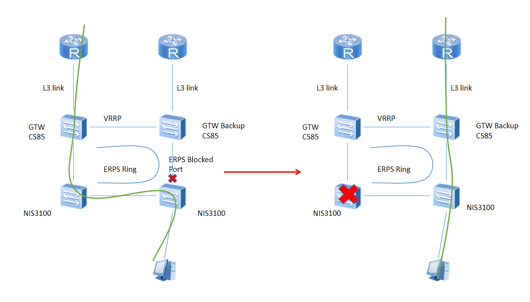

if we similate a link failure on 1 NIS switch:
we recover the link and we simulate a device failure:
we check the gateway is correctly switched over to backup device:

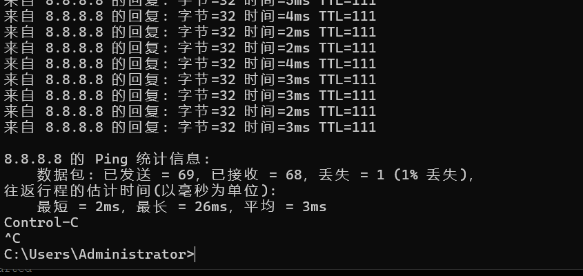

we can check the traffic is switched over, and we have only 1 packet loss

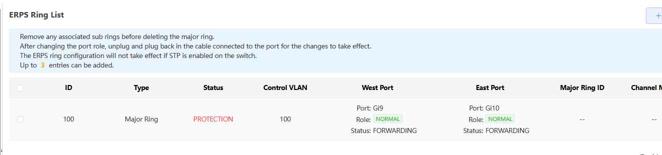

after the reboot, the Master gateway is restored and check the ERPS status again:
