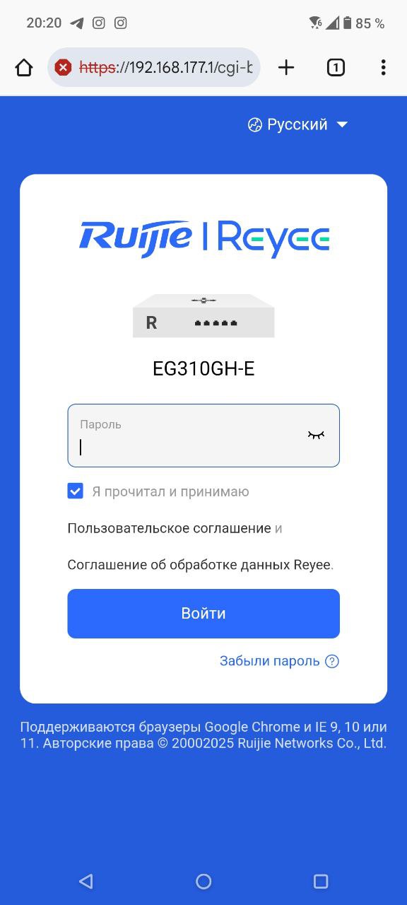

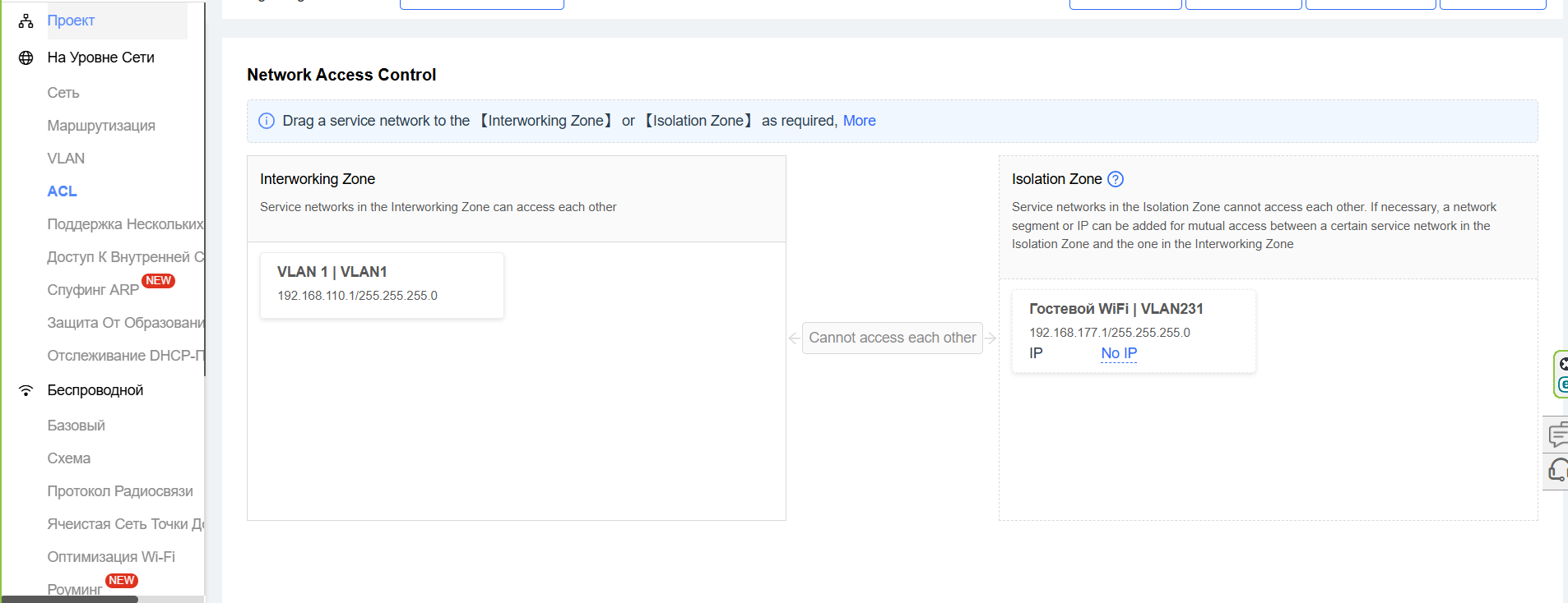

the thing is that I'm not talking about the working network, I'm talking about the guest network and the guest network which is on 192.168.40.1 and then you go to that IP and it sees the router on it, although the router is in the main network which is in a different pool, the working one
I'll give you an example right now. I have a main network and a guest network, I'll show you the screenshots.
and so, finding myself in the guest network, I enter 192.168.177.1 and getting to the router, this is nonsense, this shouldn't happen, my main network is different
here is a screenshot from the guest network as you can see in the guest network

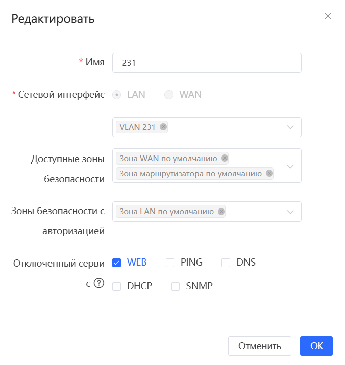

I realized that no one needs me, I decided to support ruijie through engineers and for now I explained and showed clearly here is an example screenshot of what needs to be done for the guest network so that users do not see the router, this is in the firewall
