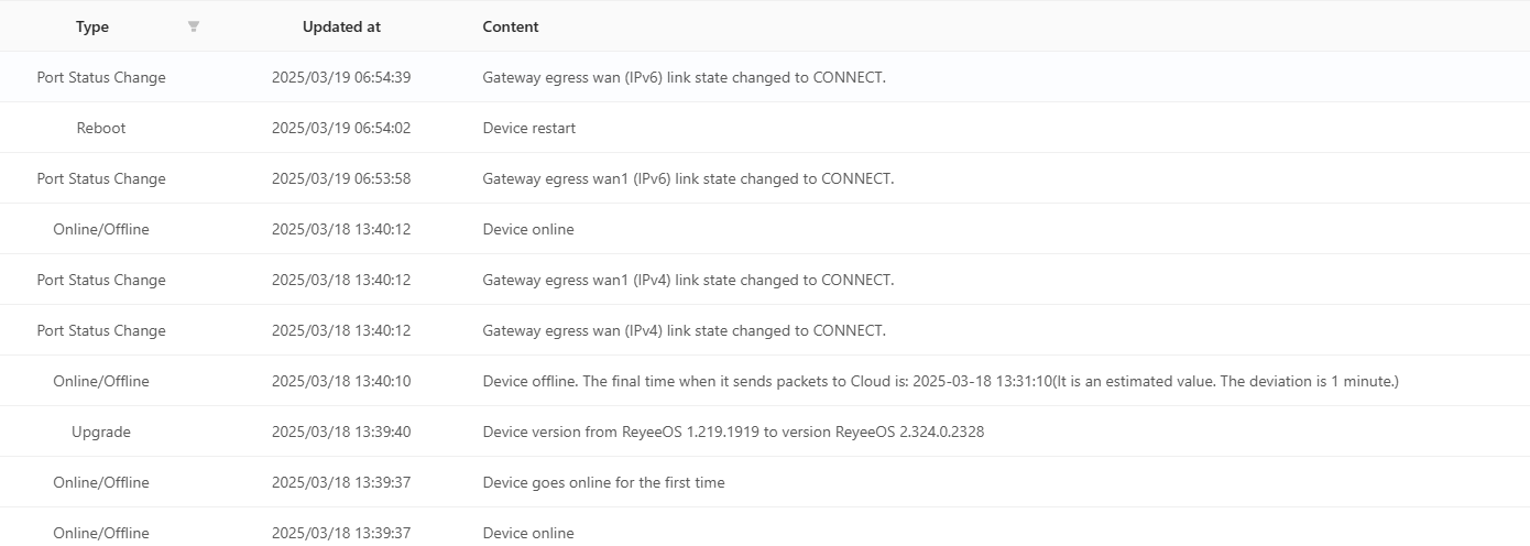

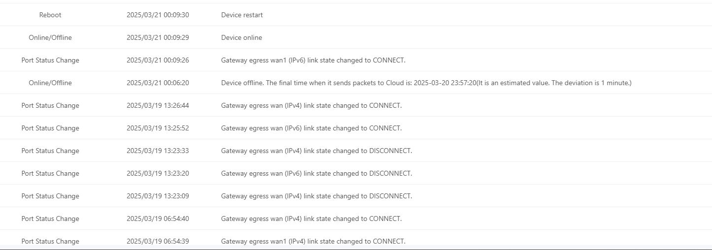

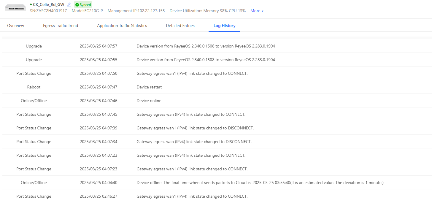

Good Day,
I have a EG210G-P at a client that keeps rebooting. I even went as far as replacing the router with the same model and it does the exact same thing.
We downgraded the firmware version from ReyeeOS 2.340.0.1508 to ReyeeOS 2.283.0.1904 to see if that would help.
I checked the power and everything that could affect it but that was all ok.
