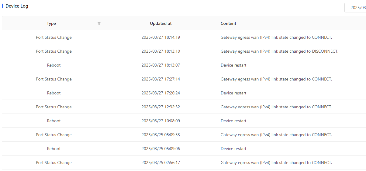

5555 12 2025-3-27 18:23:14
Can I ask why EG105GW(T) is always rebooting? I already check the power and firmware is already updated

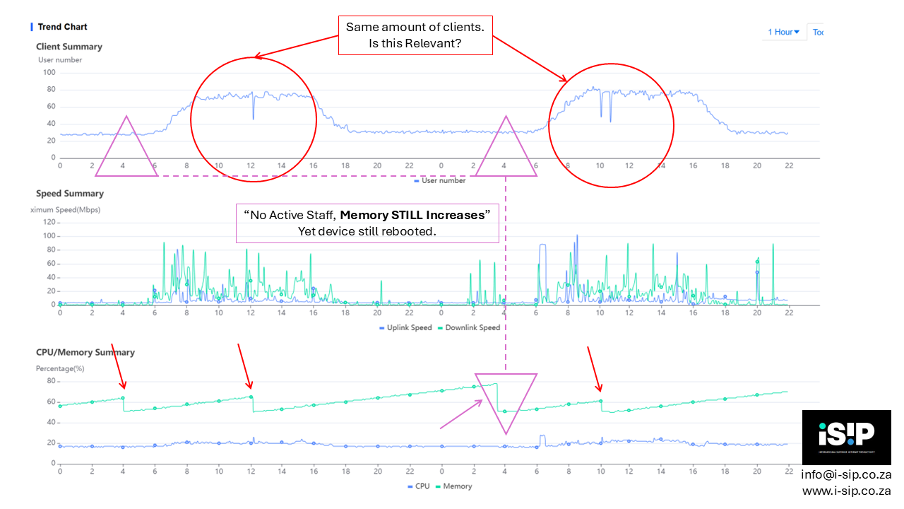

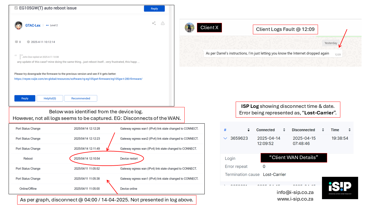

Good day,
I have been experiencing the same error recently. After numerous tickets logged with the ISP and troubleshooting the internal network, I have finally come to the conclusion that the device might be running out of memeory and then a reboot commands is most likely delivered to free resources. As every time my device reboots, it seems that the memory reach +- 80%. runs again until memory reaches 80%.
Looking at the graphs, it also seems that when the user count is around 80 active users, the amount of processing and resources being used, increases the time intervals between each reboot.
Perhaps the device is not clearing any sessions as it suppose to?
Is there anyone else that noticed this on their router aswell, there must be a common factor amongst us that we can identify and bring to light.
Regards, Q.Büchler.
Graph indicating the event times.
Note: date frame @ times of the graph are: 14 April 2025 @ 00:00 until 15 April 2025 @ 23:00.
Email subject with backup files, tech support log files has been sent.
Email Subject: TID: 12230 ___ (EG105GW(T) Auto Reboot Issue)
No downgrade has been carried out as yet.
Current Version: ReyeeOS 2.340.0.1508
Model: EG105GW(T)
