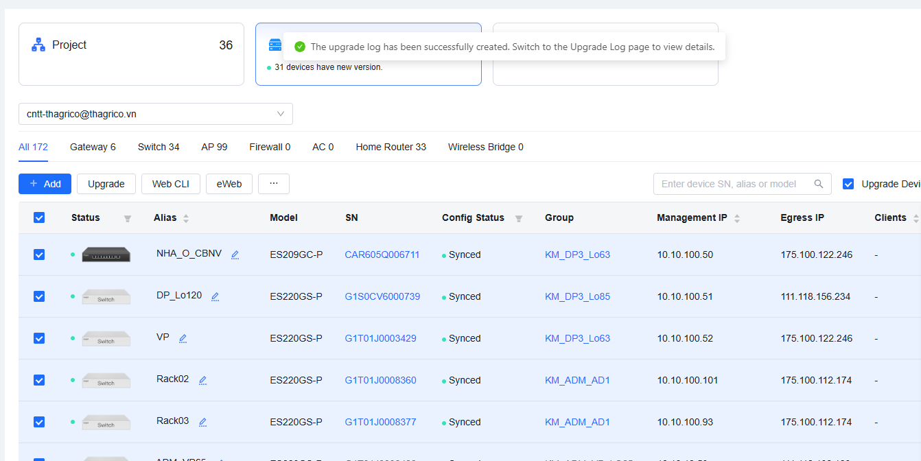

I've updated switch but it's not work. Pls help check!

Hi sir,
All my model: ES220GS-P,
ES209GC-P,
ES205GC-P can not update, but the have been annouced that are updated.

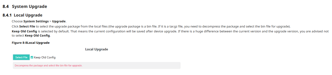

Dear customer, you can download the latest firmware for them and upgrade them locally in the web.
ES220GS-P: https://reyee.ruijie.com/en-global/resources/software/es220gs-p-firmware/es220gs-p-es228gs-p-p39/
ES209GC-P: https://reyee.ruijie.com/en-global/resources/software/rg-es205gc-p-b1p27-software/es205gc-p-p35-firmware/
ES205GC-P: https://reyee.ruijie.com/en-global/resources/software/rg-es205gc-p-b1p27-software/es205gc-p-p35-firmware/

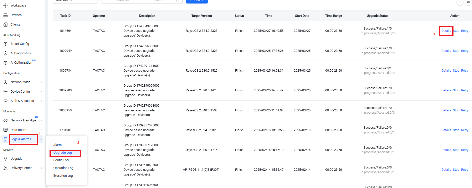

To figure out why online upgrade failed, you can check the upgrade log on the cloud.
For any further assistance regarding the online, we also encourage you to contact us on Rita(www.ruijienetworks.com/rita), we can help you check it via project sharing.
