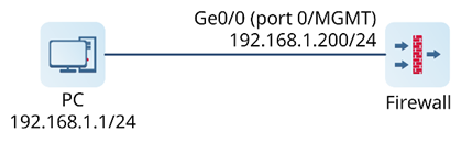

Application Scenario
When you want to configure the device or collect information in CLI management mode,but you do not have a configuration cable or you are far away from the device,you can remotely log in to the device using SSH.
Network Topology
Configuration Points
To usethe SSH login method, the connectivity between the management PC and themanagement interface address of the device must be ensured. After the pingfunction is enabled on the interface, the management PC must be able to pingthe management interface.
(1) Enable the SSH function on the interface.
(2) Manage the device using SSH.
