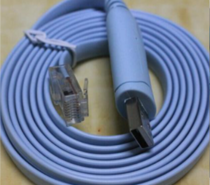

  • Console cable

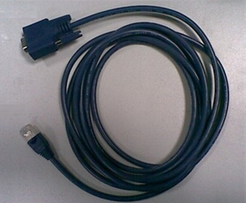

Model 1: Connect one end of the cable to the 9-hole DB9 connector andthe other end to the RJ45 connector.
Model 2: Connect one end of the cable to the RJ45 connector and the otherend to the USB connector.

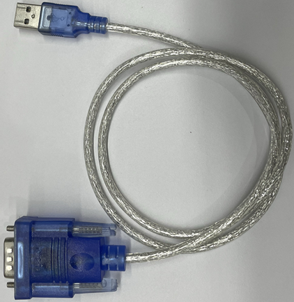

  • PC with a COM port: The COM port of the PC is usually located nearthe display interface on the rear panel of the chassis. The COM port has ninepins, as shown in Figure 1-2.
If your PC does not have a COM port (such asthe laptop), the USB-to-COM cable (as shown in Figure 1-3) must be connected to the USB port toconvert it into the COM port. You can also use the USB-to-console (RJ45) cableof
Model 2 directly.

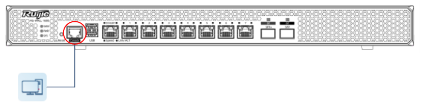

(1) Connect the configurationcable.
a Insert the RJ45 connector ofthe console cable to the console port of the device (as shown in the followingfigure).
b Insert the DB9 connector on theother end of the console cable to the 9-pin COM port of the PC.

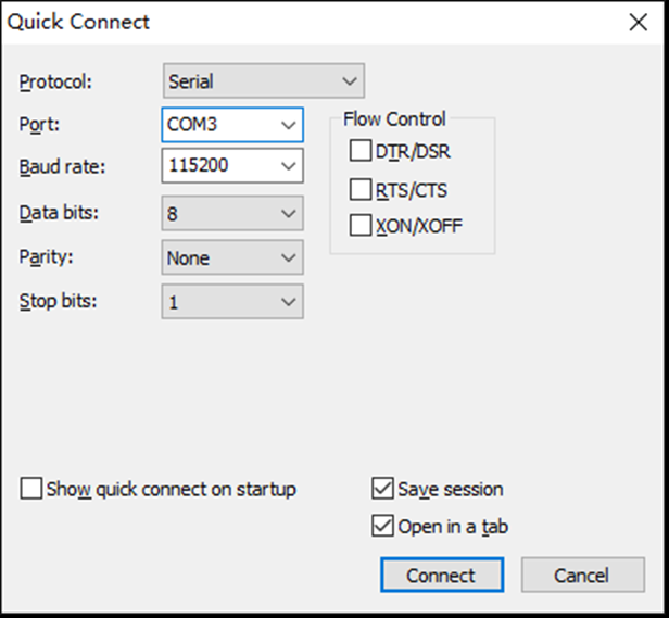

b Run the SecureCRT software. The QuickConnect dialog box is displayed automatically. (If the dialog box is notdisplayed, click in the menu bar.) In the dialog box, set theconnection parameters and click Connect.The following table describes the connection parameters that you need to set.
   Parameter      Value
  Protocol
  Serial
  Port
  COM port of the  PC identified in the previous step
  Baud rate
  115200
  RTC/CTS
  Deselect

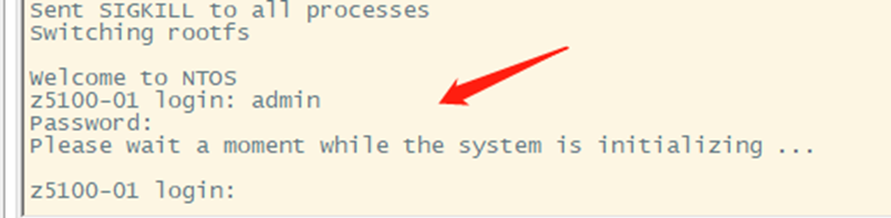

It takes acertain period of time to complete system initialization after the device ispowered on and started. You are advised to wait until the system is readybefore running CLI commands.
