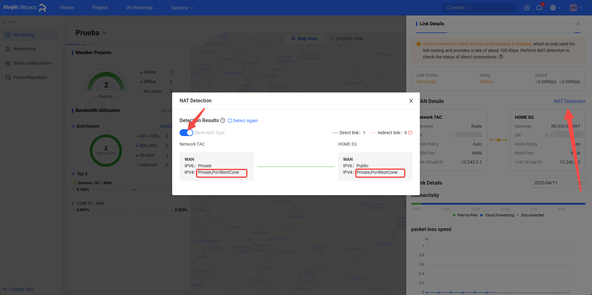

This issue can be due to the NAT type of connection, this is going to depends on the isp. From link detail you can check the NAT detection as follows
Depending on the scene the tunnel are going to fail or not
Regards!

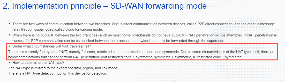

Thankyou for explanation.
So that means, if one of the ISPs detects symmetric, NAT will fail.
How to change NAT type from symmetric?.
or only one solution is should change ISP?
