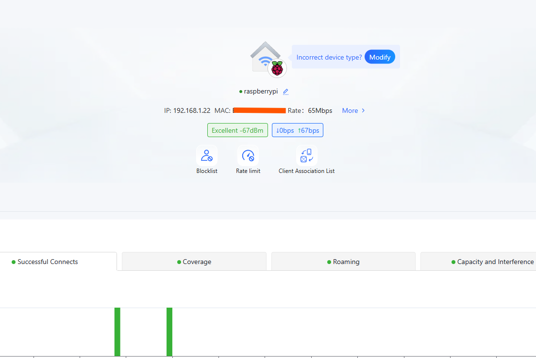

I have a Raspberry Pi that I use as a media server on my local network, and I would like to assign it a static IP address. Typically, this is done through the DHCP settings, but I couldn't find the option in the mobile app. I also accessed the web interface, which has many more options, but I still couldn't locate the DHCP settings.
Could you please guide me on how to assign a static IP to my Raspberry Pi within the network? Any advice would be greatly appreciated.
Thank you for your assistance.

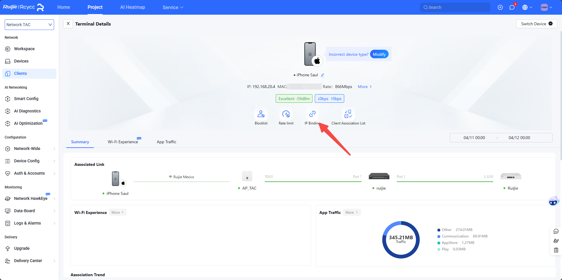

Hello, from cloud you can apply an ip binding on the desired client once it is connected in the network.
after that the ip are going to be assigned to the device verytime it reconnects.
Regards!

Thanks a lot for your answer @TAC-Saul ! I tried but I don't see the 'IP Binding' option 🤔 I wonder if maybe my device doesn't support it (which I doubt, as this is a basic feature) or the guy who set up my network just didn't give me enough permissions
