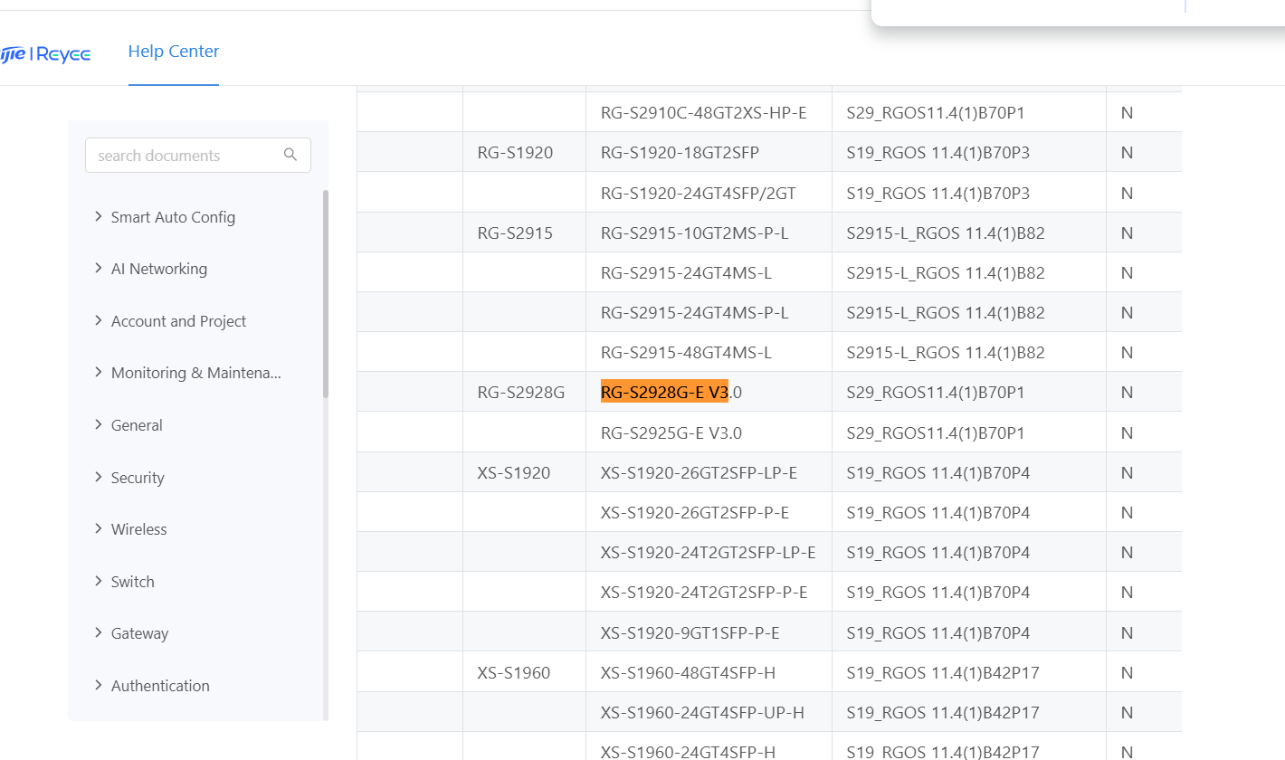

Hi,sir
Regarding your question, you can refer to this link to go to the cloud:https://community.ruijienetworks.com/forum.php?mod=viewthread&tid=767&extra=page%3D1

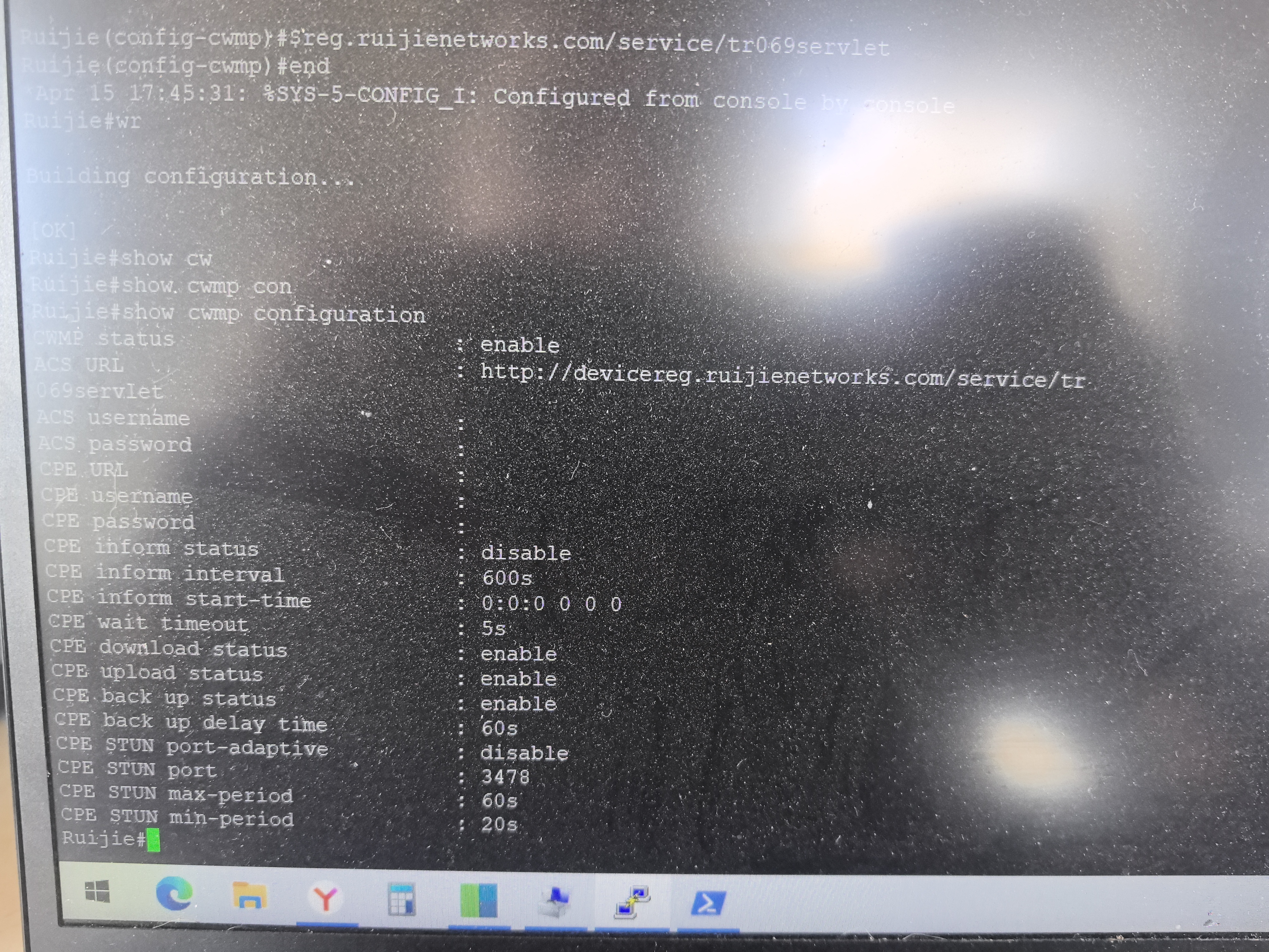

Tried it, and nothing.
Tried devicereg, cwmpsvr-as and eu...

THE FINAL!
So, summing up the higher-level advice, I still succeeded)
1. After connecting via the CLI, I updated the firmware to the latest
2. Reset the switch to factory settings
3. I connected via the CLI again, set the IP, checked access to the Internet, turned on the web interface, and checked its availability.
4. Again, through the CLI, I performed the steps to add ACS, after which, after 5 minutes, the switch was perfectly identified and became available through the cloud.
