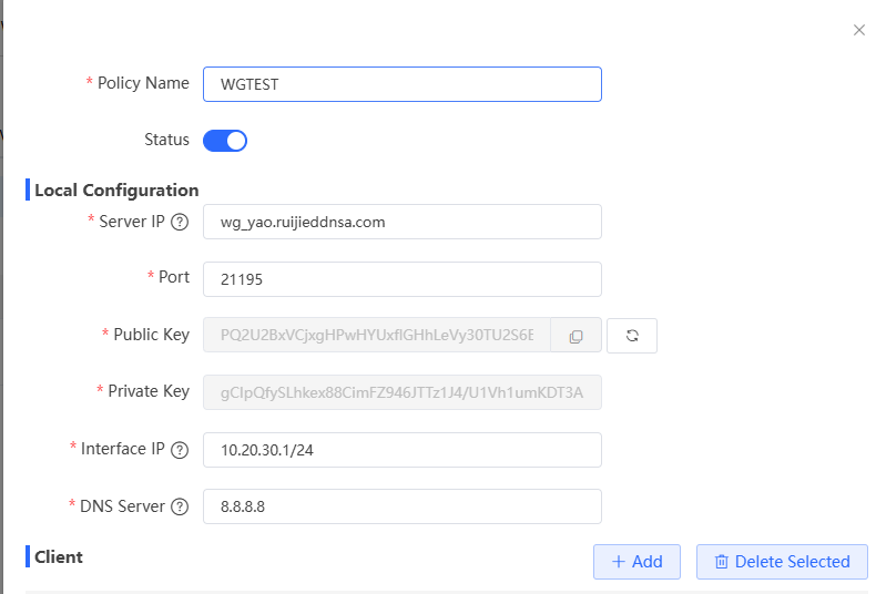

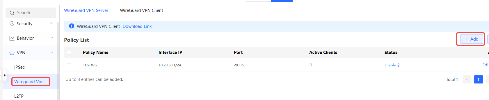

1. Go to the device eweb, click on VPN>Wireguard VPN> Wireguard VPN server> Add
2. Configure the server parameters of the VPN click Add for adding some Wireguard clients

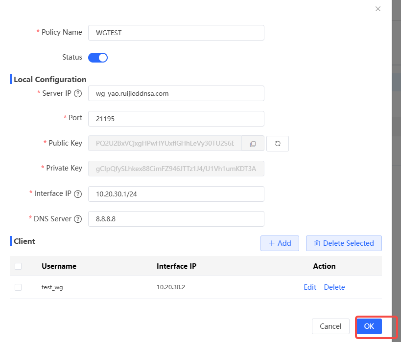

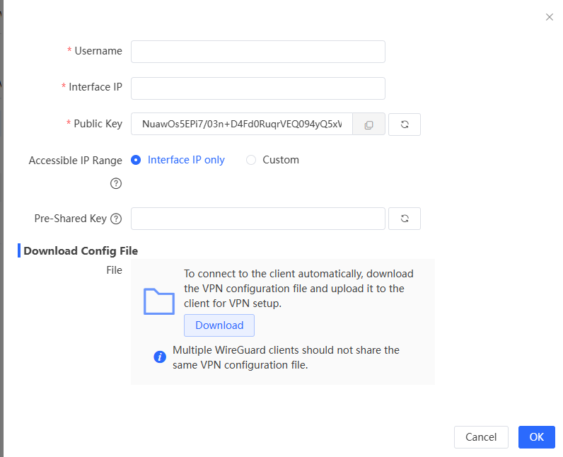

3. For add a user, input the username and user interface IP, and click
4. After adding the client, click OK for save the configuration

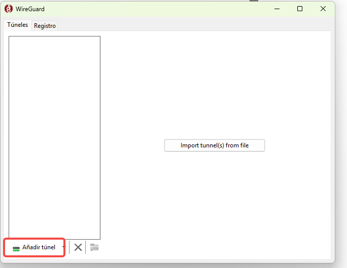

5. Download the wireguard client and import the configuration file to connect to the server.

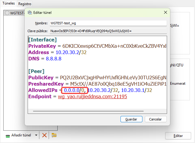

note: if you experience that you can connect the VPN but no traffic is received, try to delete the configuration file 0.0.0.0/0 and check if it works:

The issue, if I set wireguard client on eg and would like to specified src address traffic routed via wireguard interface with PBR.
The traffic will not goes over wg.
But if I add 0.0.0.0/0 on wireguard client configuration, all traffic will goes over wg.
How do I solve this issue. It's look like the wg client config will overwrite global routing table

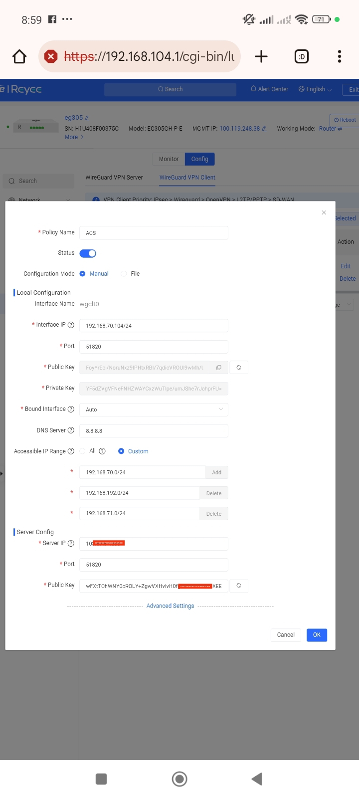

This is my wireguard config, when i add 0.0.0.0/0 in allowedIPs, the whole traffic will route via wireguard.
I just want to use specified traffic route via this interface for example hence PBR url routing.
