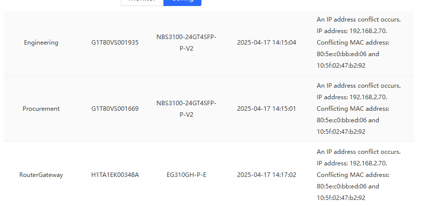

I see when a user walk around between Access Points, I get a error message for 2-3min IP terminal conflict, then it disappears. How can I resolve this problem? Roaming is set to 40% on all Access Points, DHCP lease set to 2 days

I am glad to receive your message. Can you take a screenshot of this message and send it to me? This will help me understand the problem more intuitively.

IP conflict 192.168.2.70 on device Gi26. Cause: MAC 105f.0247.b292, SN: G1T80VS001652;MAC 805e.c0bb.ed06, the source of conflict may go through the switch and port: Port G1T80VS001652 of the switch Gi26ort G1T80VS001669 of the switch Gi18ort G1T80VS005406 of the switch Gi28.
IP conflict 192.168.2.81 on multiple devices: MAC 105f.0266.345f, SN: G1T906G004885;MAC 805e.0c6d.95f4, the source of conflict may go through the switch and port: Port G1T80VS001652 of the switch Gi11
IP conflict 192.168.2.76 on multiple devices: MAC 805e.c0bb.f4ae, the source of conflict may go through the switch and port: Port G1T80VS001652 of the switch Gi26ort G1T80VS001669 of the switch Gi22ort G1T80VS005406 of the switch Gi28;MAC 105f.0241.3c14, SN: G1T801M00115C

Thank you for your reply, sir. Have you checked which device the address 192.168.2.70 belongs to? Is there any user who manually changed the terminal to this address, causing a conflict? In addition, we can also check whether there is a conflict in the address pool configuration.
