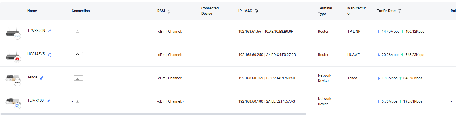

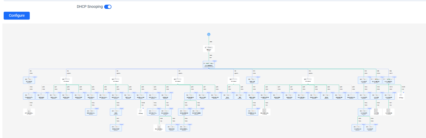

Hi Micca,
I’d like to confirm that DHCP Snooping is already enabled across all switches (please refer to the attached screenshot for reference). This has been effective in preventing rogue DHCP server issues.
However, I’d like to take this a step further—is there a way to block non-Ruijie/Reyee devices (as seen in the screenshot) using MAC address filtering? For example:
Whitelist only Ruijie/Reyee MAC addresses on the network.
Block unauthorized MACs (particularly personal routers/APs).
Could you recommend the best approach to implement this? Potential solutions I’m considering include:
1. Port Security – Restrict switch ports to specific allowed MAC addresses.
2. MAC-Based ACLs – Deny traffic from non-approved vendors.
3. DHCP Snooping + DAI (Dynamic ARP Inspection) – Add an extra layer of protection against spoofing.
If there are any recommended CLI commands, configuration guides, or best practices for achieving this on Ruijie switches, I’d greatly appreciate the assistance! I’m happy to test this in our lab environment before deployment.
