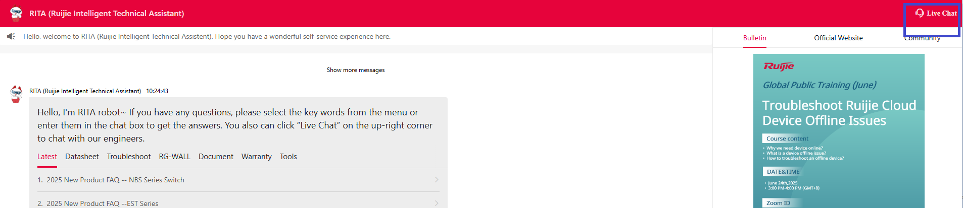

Dear customer,
To determine the the cause of this issue, we will need to check the project test the reachability of the VPN connection. Therefore, to share the project safely, we encourage you to contact us on Rita(www.ruijienetworks.com/rita), our real-time support platform. Our dedicated engineers are readily available to resolve your issues promptly.
You can click "Live Chat" on the top right corner of the page to contact our engineer.
