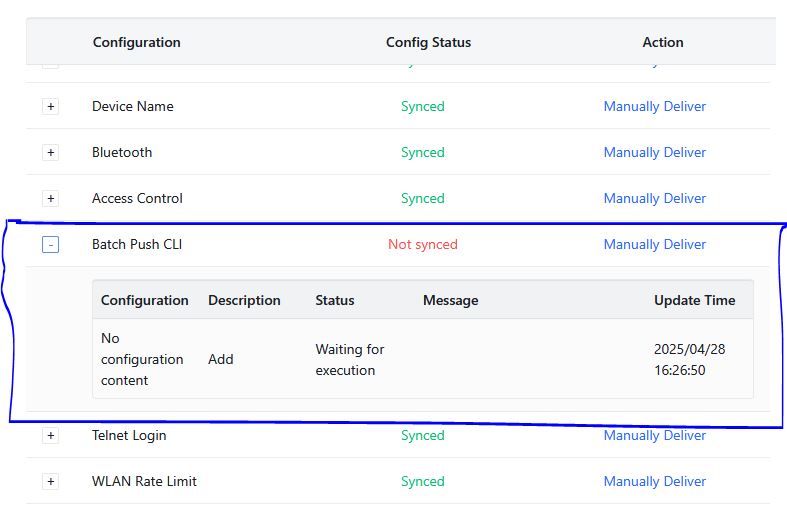

AP on cloud stuck at syncing
2342 2 2025-7-3 10:57:10
Edited by Pusdatin UMKendari at 2025-7-3 11:09
It's trying to sync a non existing configuration. How to get rid of this?
I tried manually deliver and restarted the device. not working
RG-AP720-L

Have you tried to manually send the configuration? Or you can try restarting the device or logging into the device WEB interface to check whether the configuration is synchronized.
<img alt="image.png">
0 2025-7-3 11:07:12 View all replies
Solution:
create a dummy config task
