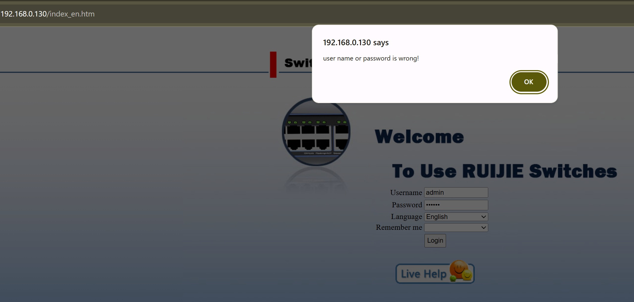

Hi,
I have problem to login via web management as follows.
But it says username or password is wrong.
I have set the IP for web management successfully and set the password using the following command via console.
But it seems the login still not working.
Ruijie#configure terminal
Ruijie(config)#username admin password ruijie
Ruijie(config)#username admin privilege 15
Ruijie(config)#ip http authentication local
Ruijie(config)#end
Ruijie#*Jul  4 12:49:58: %SYS-5-CONFIG_I: Configured from console by console
Ruijie#write
Building configuration...
[OK]
Ruijie#
My router model is S2952G-E , and the show version shows as follows :
Ruijie#show version
System description      : Ruijie Full Gigabit Security & Intelligence Access Switch (S2952G-E) By Ruijie Networks
System start time       : 2025-06-30 16:13:57
System uptime           : 3:20:33:26
System hardware version : 2.02
System software version : RGOS 10.4(2b12)p2 Release(180357)
System BOOT version     : 10.4(2b12)p1 Release(160818)
System CTRL version     : 10.4(2b12)p1 Release(160818)
System serial number    : G1HDB89043541
Device information:
  Device-1
    Hardware version : 2.02
    Software version : RGOS 10.4(2b12)p2 Release(180357)
    Serial Number    : G1HDB89043541
Please assist.
