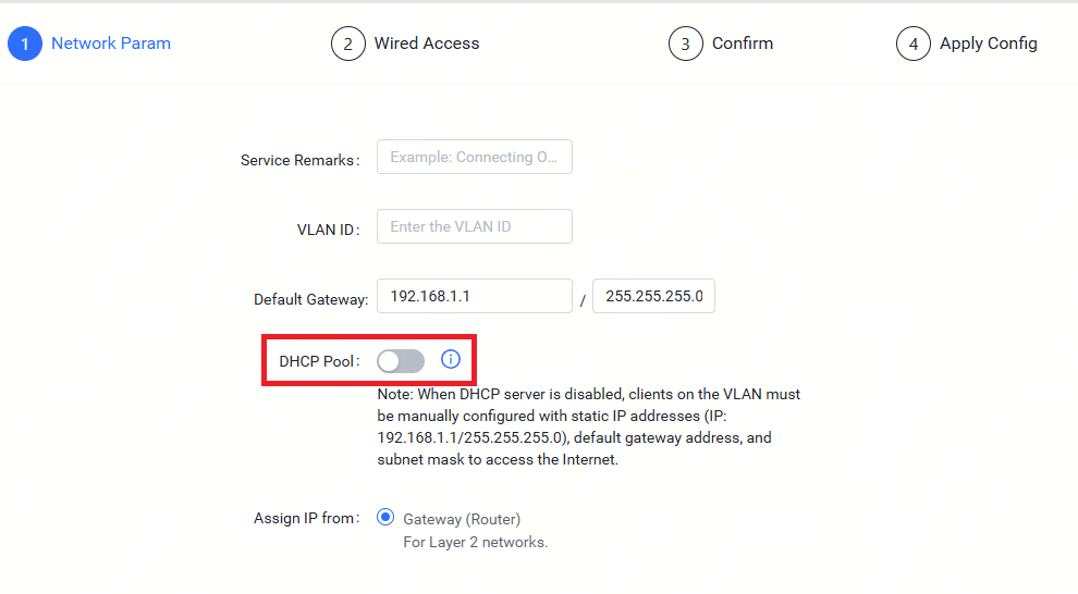

Dear customer,
When creating a VLAN, you can disabled the DHCP pool for the VLAN. You can refer to the guide below regarding more details.
https://cloud.ruijienetworks.com/help/#/ArticleList?id=e945f0446ace466b86542e2610c1c96f

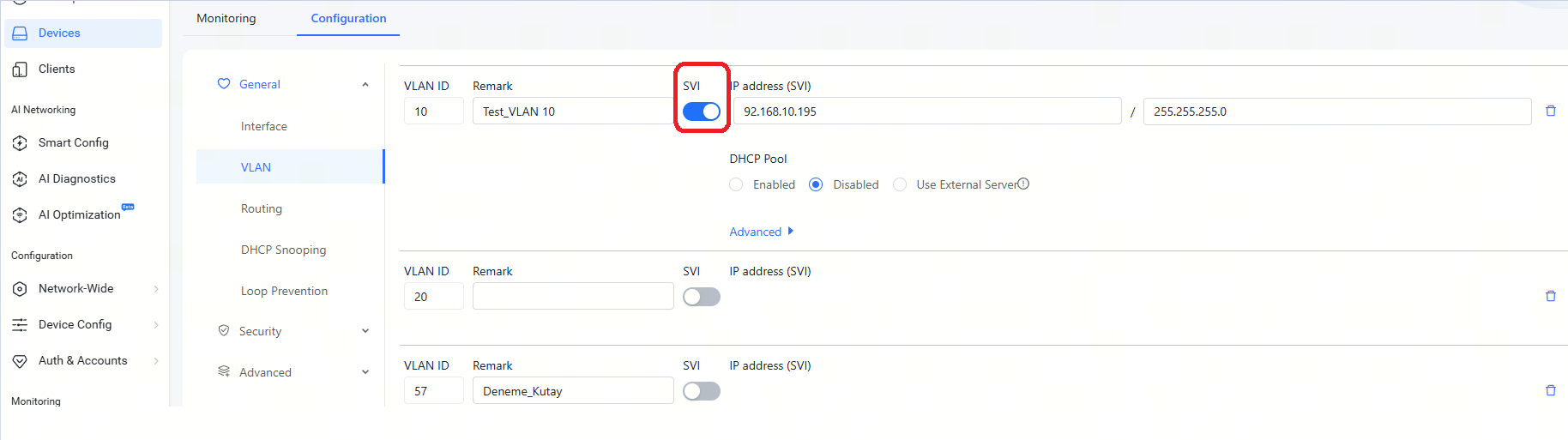

You can also disable the DHPC pool on an existing SVI in the device config page. The alarm in your project will be cleared about 9 minutes later after the issue is resolved

VLAN 10 is for AP Wi-Fi. After I disabled the SVI, my phone could no longer obtain an IP address.
0 2025-7-15 19:39:09 View all replies
User 71496 replied at 2025-7-15 16:56
SORRY VLAN20
