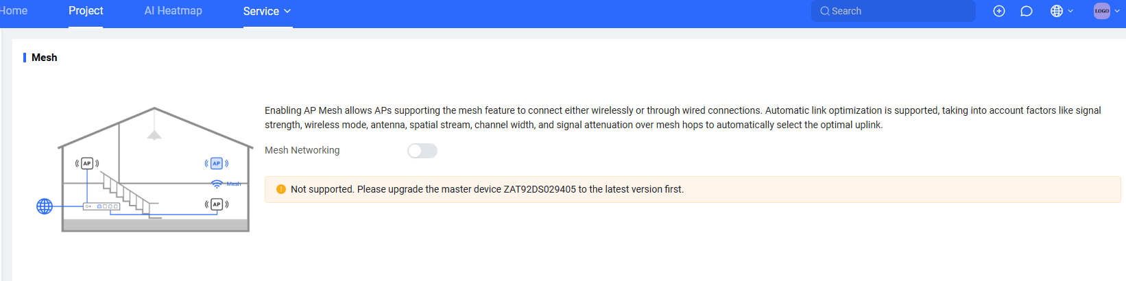

The packaging mentions support for Reyee Mesh, but I'm unable to enable it on the configuration page.

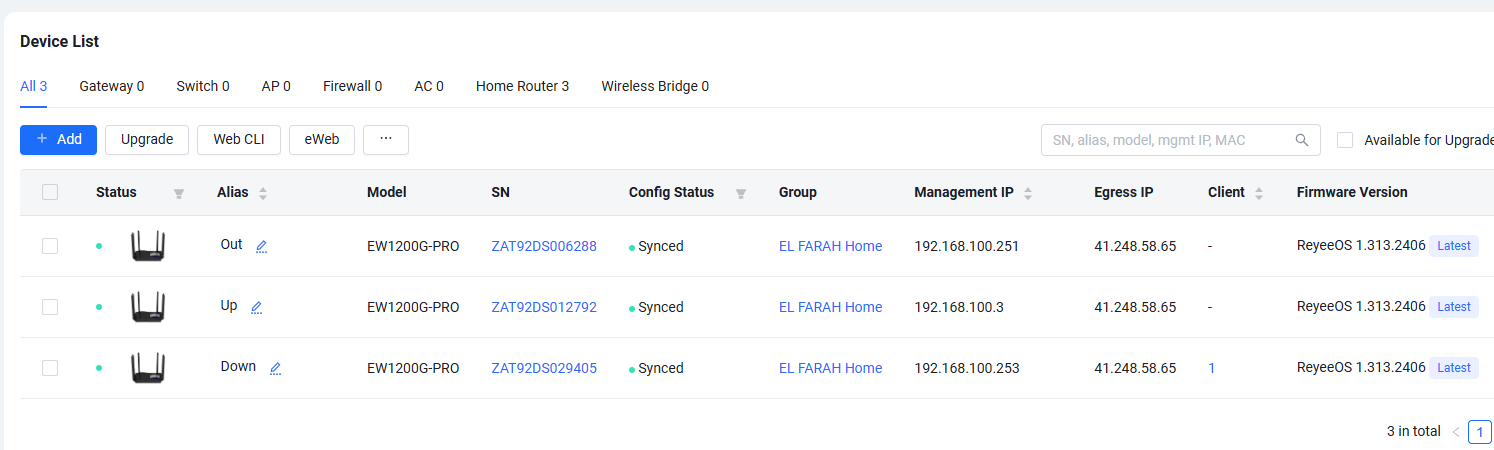

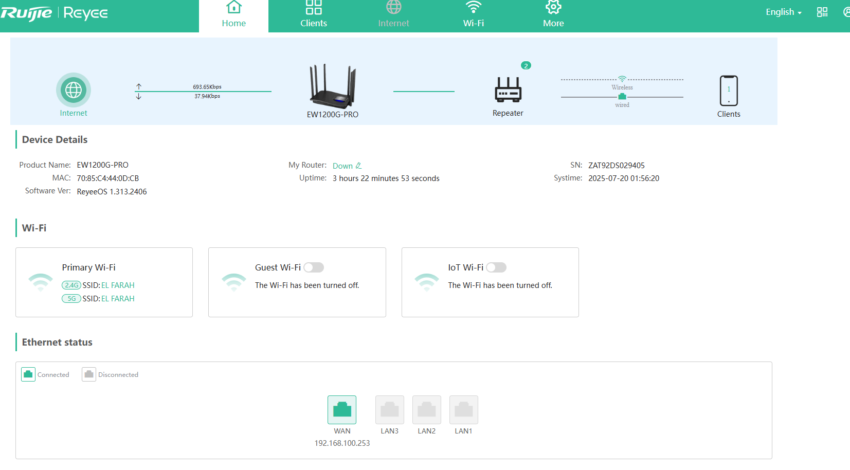

I have a Huawei fiber optic router and three RG-EW1200G Pro devices operating in AP mode, all connected to the router via Ethernet through the WAN port on each device. They are all updated to the latest firmware.
Please advise.

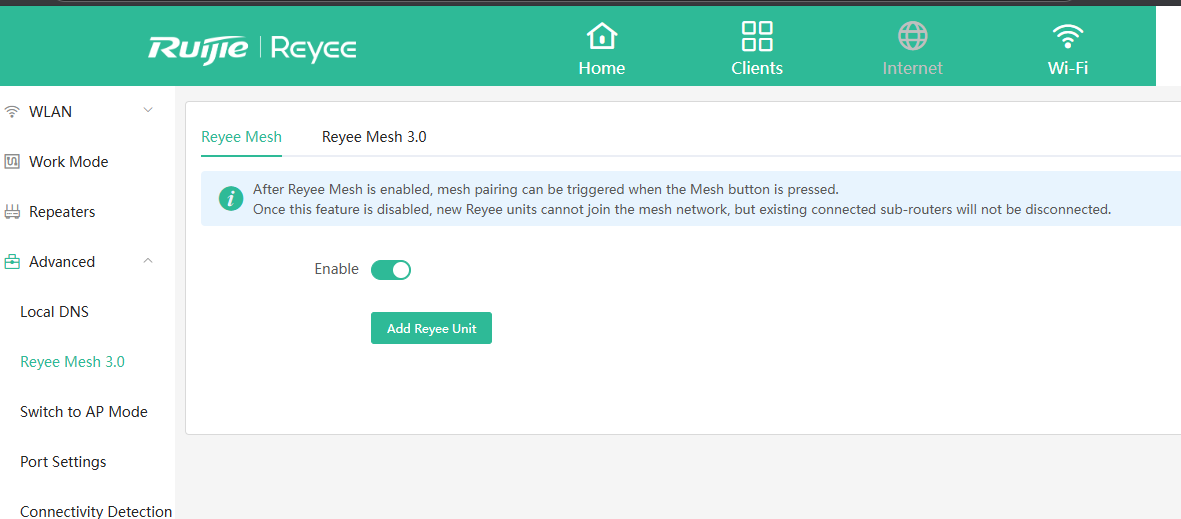

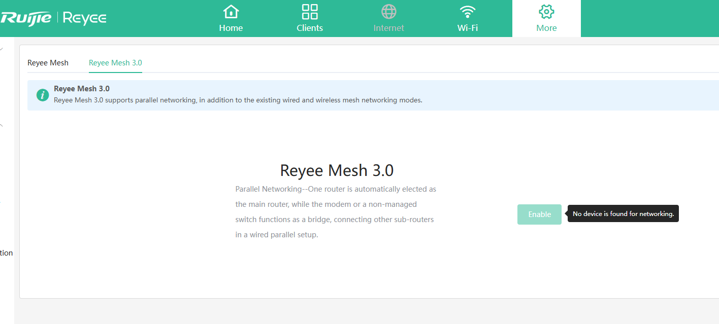

The AP mesh page is specifically designed for Reyee APs, not Home wi-fi models.

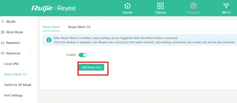

If you need to connect another Home wi-fi unit wireless via AP mesh, you can connect it by pressing "Add Reyee Unit"
You can also mesh a Home wi-fi unit by pressing the mesh button. Here is a tutorial on how you can do it.
https://www.youtube.com/watch?v=XCNGSi3AssE
