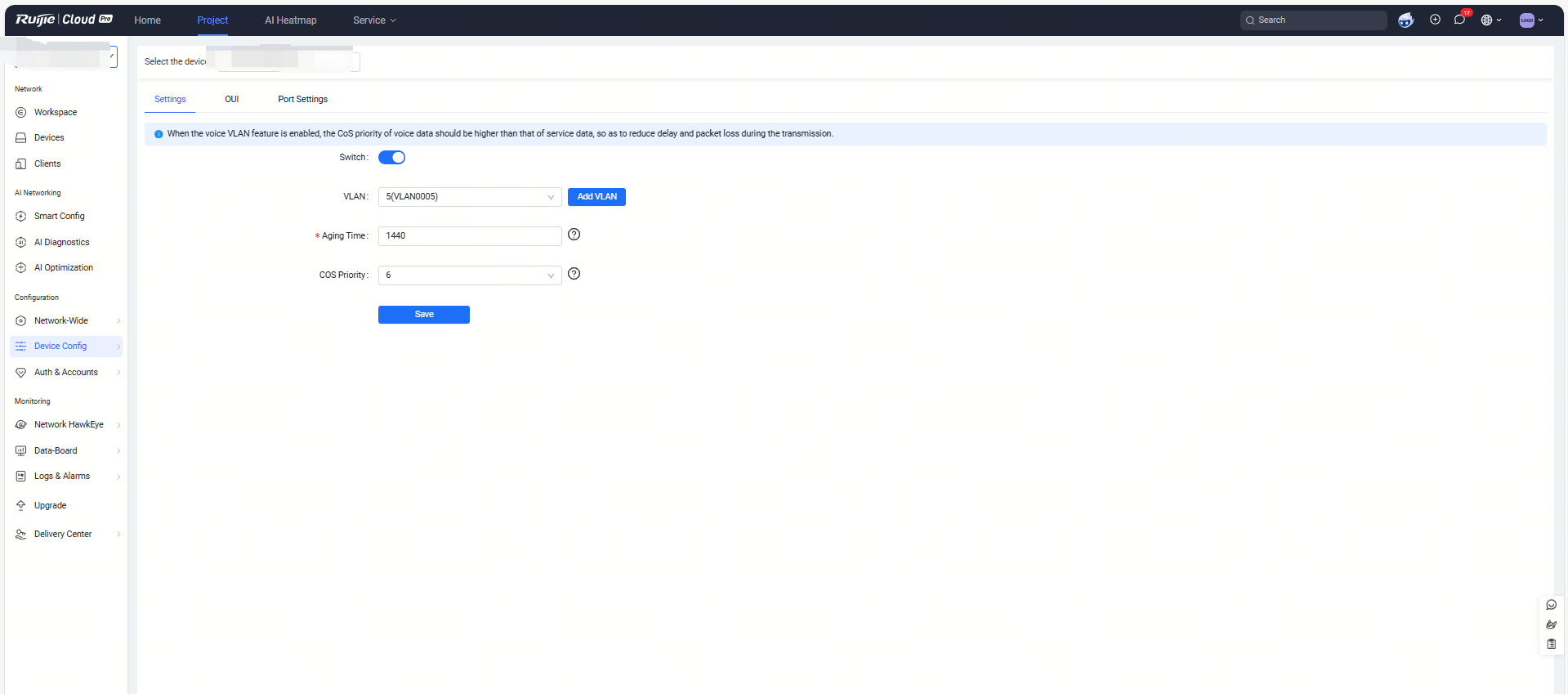

Step 1: Check the global Voice VLAN configuration
Path: Project > Device Config> Voice VLAN > Settings
Requirements :
Enable the Voice VLAN feature.
Set the correct VLAN ID (e.g., 5).
The aging time defaults to 1440 minutes (adjustable).
CoS priority is recommended to be set to 6 (to increase the priority of voice traffic).

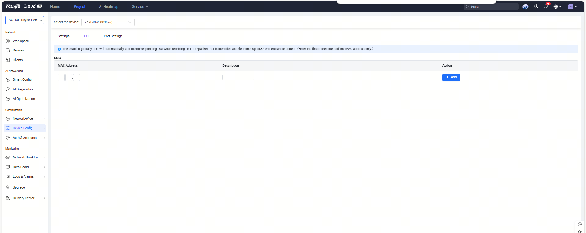

Step 2: Configure OUI
Path: Project > Device Config> > Voice VLAN > OUI
Operation:
Add the MAC address prefix of the voice device (e.g., 00-1B-63).
If the device supports LLDP, it can automatically learn OUI (the port Voice VLAN function needs to be enabled).
