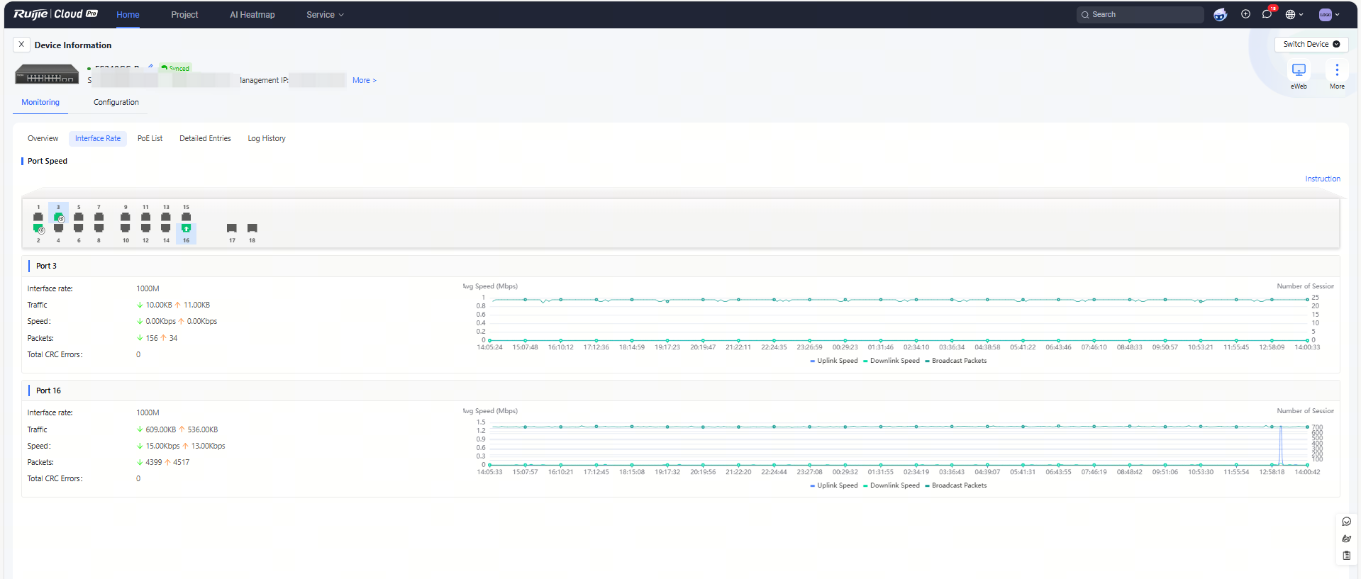

Check Port Traffic and Stability:
  • Login to the Device: Ensure that the corresponding port traffic is normal and stable. This can be done by logging into the switch and checking the port status.

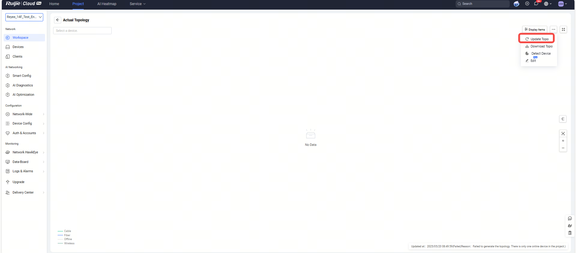

  • Wait for Recognition: It may take up to 20-30 minutes for the camera to be recognized. If the camera is not visible in the cloud after a long wait, you can manually update it.
