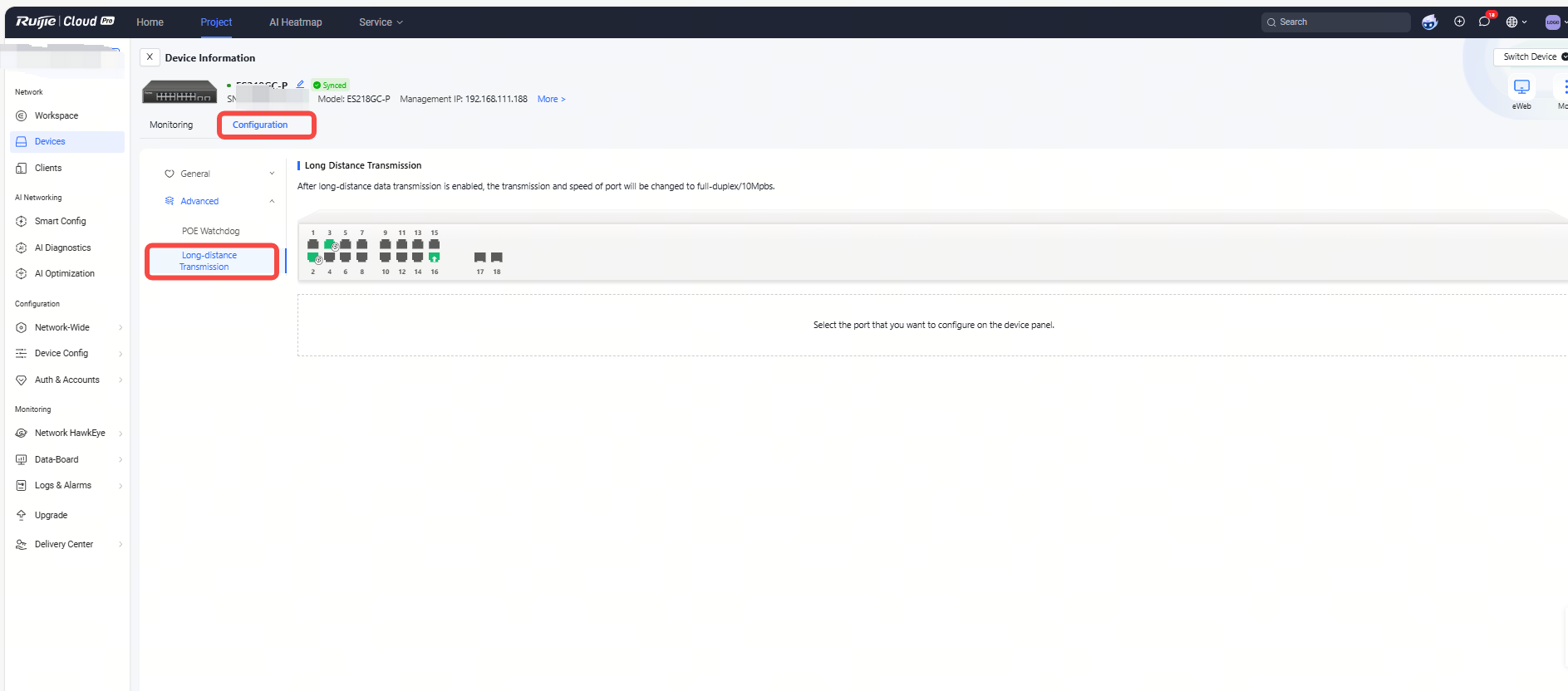

1.Check whether Long Distance Transmission enabled
