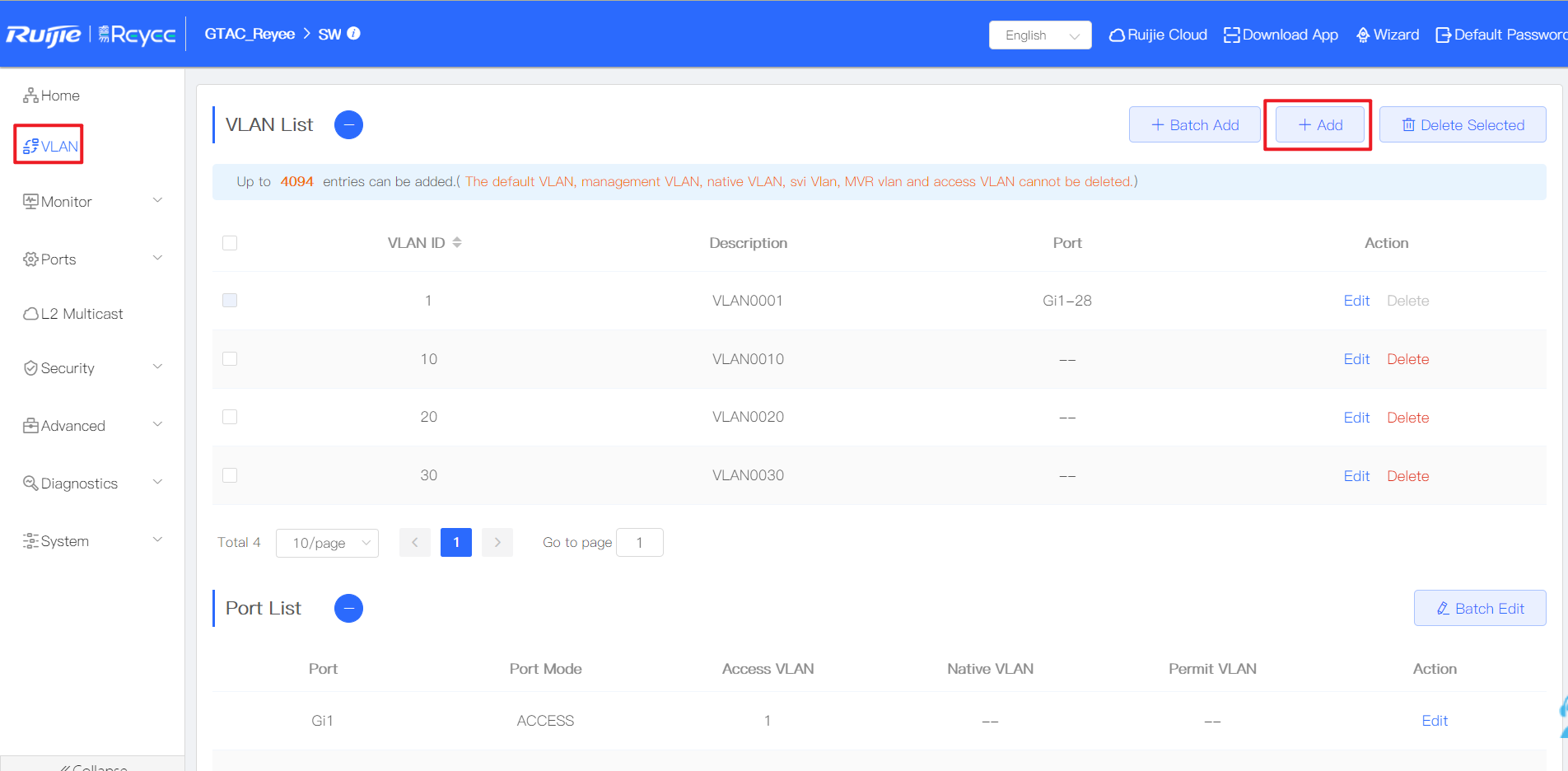

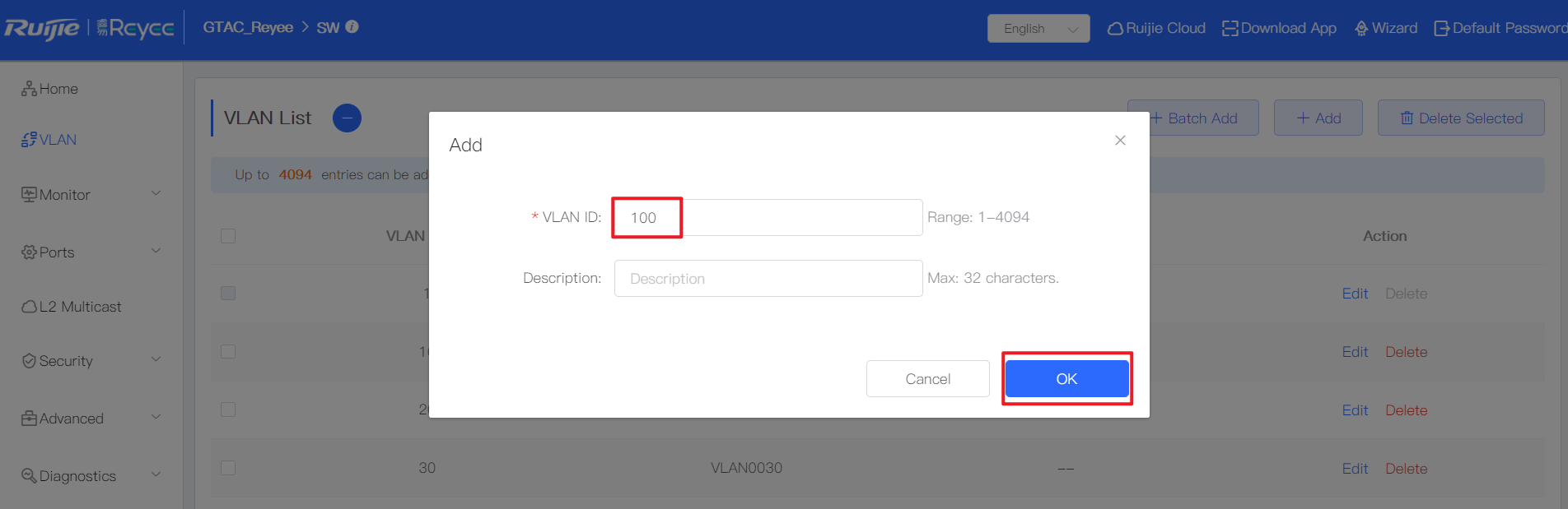

Step 1: Click Add to add a VLAN member

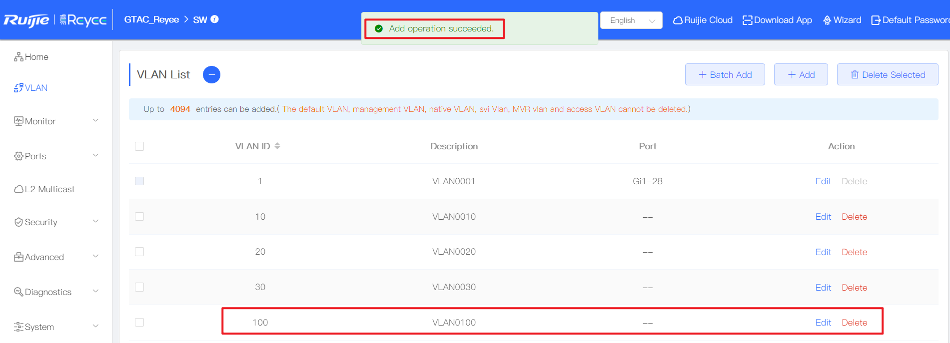

Enter the vlan id :
Added successfully :

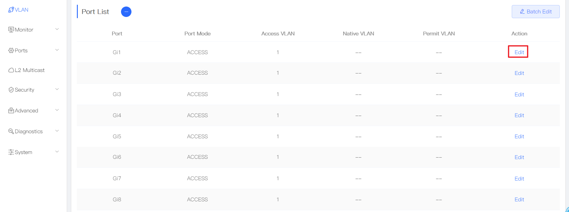

Step 2: Assign the new VLAN member to ports.

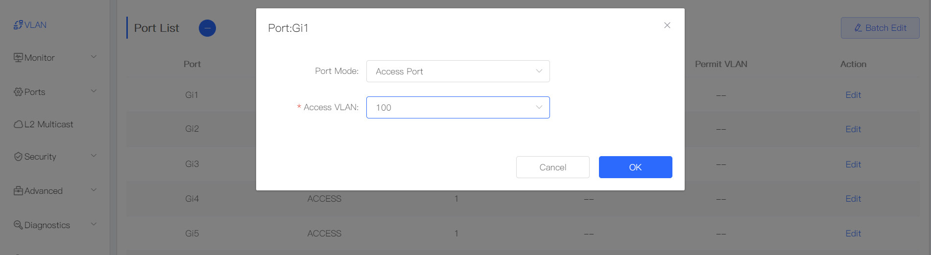

For Access port:

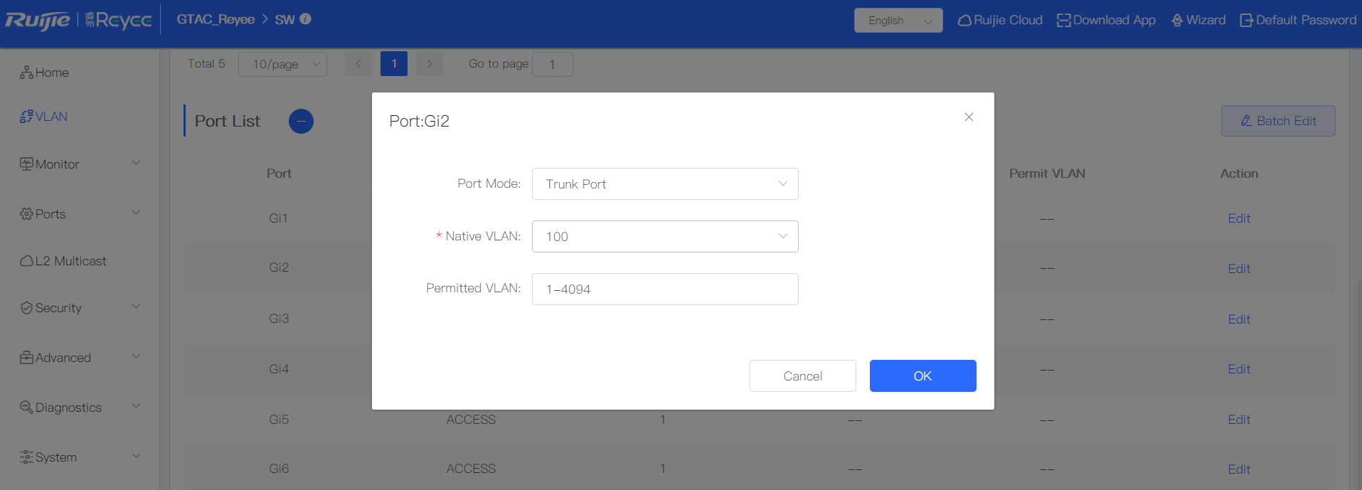

For trunk port:

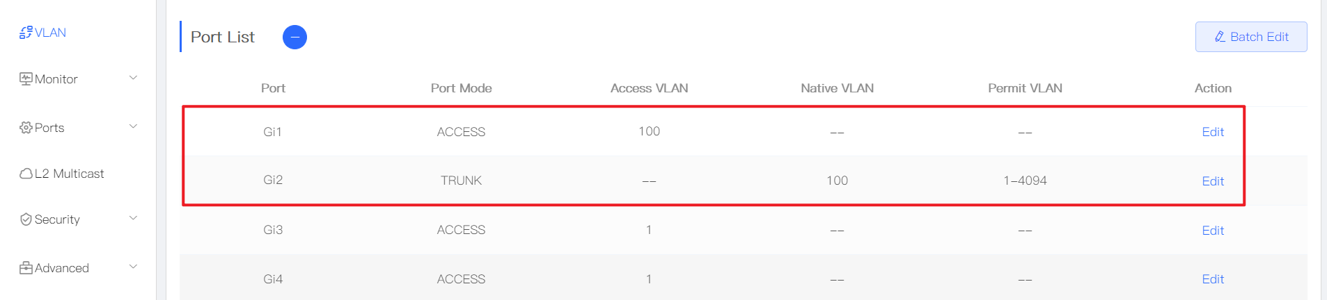

Assigned successfully:
