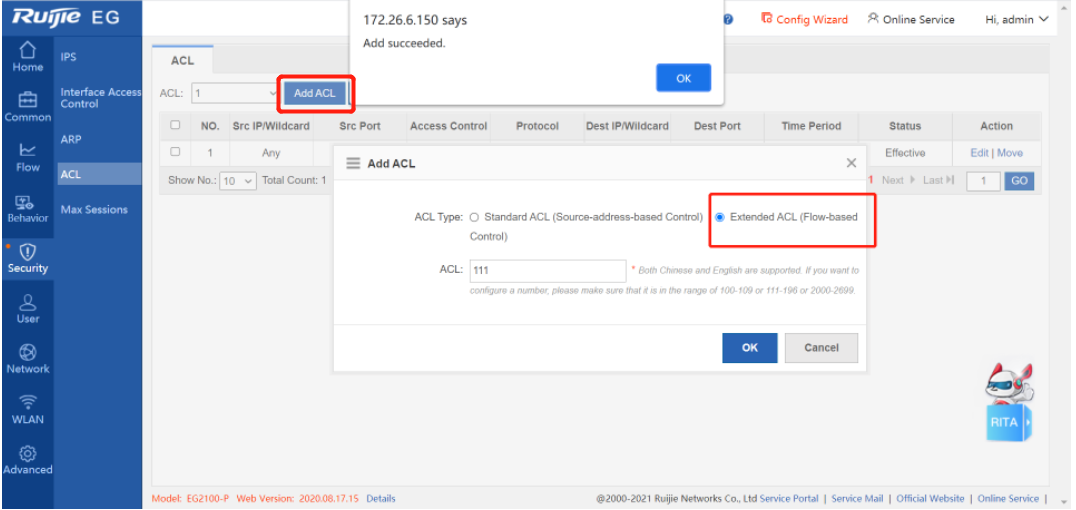

Step 2: Click Security-> ACL->Add ACL,Create an ACL 111 to deny 192.168.2.0 to 192.168.3.0
Add a permit any any rule at the last.

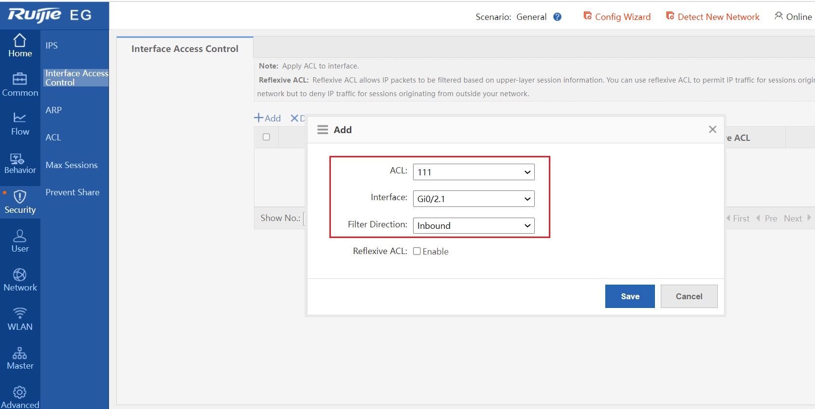

Step 3: Click ‘Interface Acess Control’, Apply the ACL to the interface.
Finally, the 192.168.2.0 can't access 192.168.3.0.
