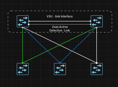

Hi
In this example, both RLDP and spanning-tree bpduguard are enabled on all interface of the switch.
how about the below command? what does it mean in the configuration and how would it affect in the network.
Ruijie(config)#interface gigabitEthernet 0/25
Ruijie(config-if-GigabitEthernet 0/25)#spanning-tree bpdufilter enable
Currently, we have the following setup: RLDP is enabled on all switches, and we're planning to enable BPDU Guard and Portfast as suggested above. I'm uncertain about whether I should enable
'spanning-tree bpdufilter'
and, if so, on which port it should be enabled, or if it can be safely ignored

Dear ICT-infra,
Spanning-tree bpdufilter enable is used to configure the port not to receive nor send BPDU packets, and the port will be in forwarding mode directly.
While the downlink ports are recommended to enable RLDP with BPDU Guard and Portfast, the command "spanning-tree bpdufilter enable" should be configured on the uplink port to prevent the STP packets from being sent to the uplink core switch and affecting the network.
