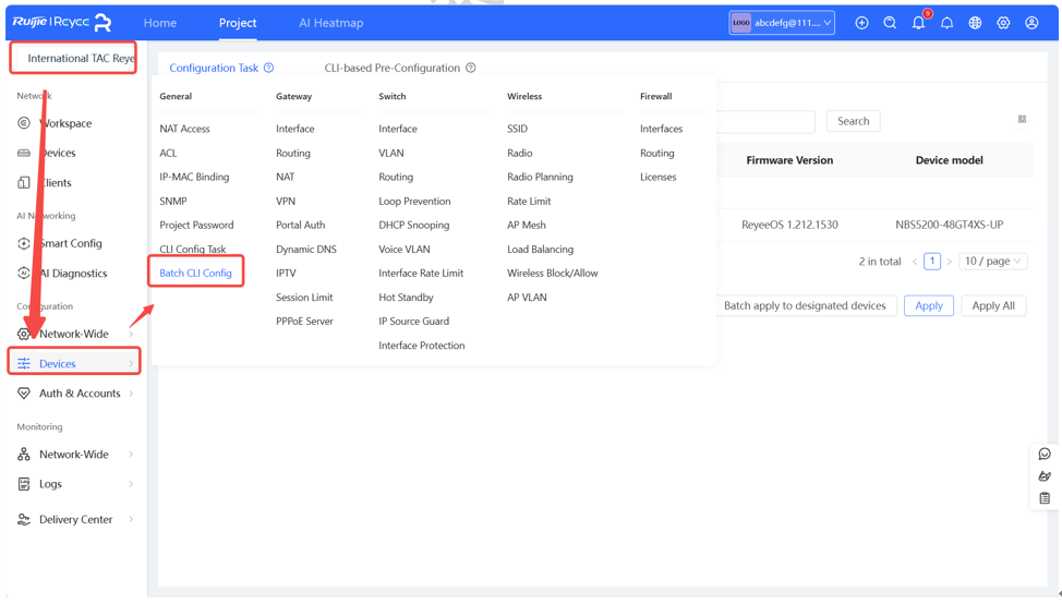

You can configure it according to the following steps.
1.login your Ruijie Cloud and choose project then Click 'Device'->'Batch CLI Config.'

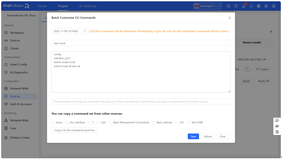

3. Configure the name of this command template and the content of the command. If you need to send it out regularly, you can choose the time to send the configuration.

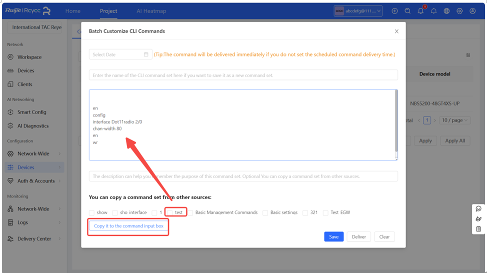

<span style=""">4.You can also choose an already created template to import
