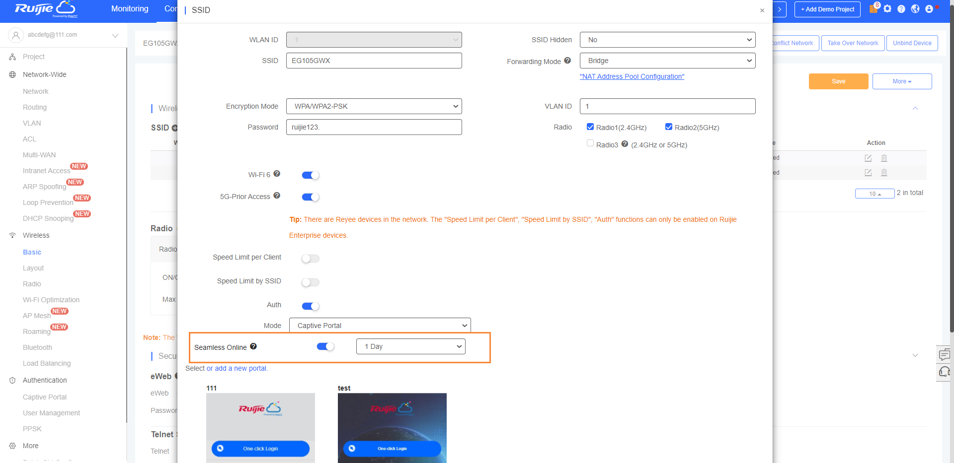

i have a problem.my case is once a user connected through wifi. next time again asked user name and password to login. automatically didn't connect
0 2023-3-21 19:33:49 View all replies
unknown unknown replied at 2023-3-21 15:30
i have a problem.my case is once a user connected through wifi. next time again asked user name and  ...
If you are doing Ruijie AP portal authentication, you can enable seamless authentication on this page so that the user no need to do authentication again when the next login:

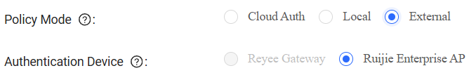

Do Reyee AP also support WiFiDog as external captive portal?
0 2024-7-18 08:15:54 View all replies
Sam Yeung replied at 2024-7-16 02:19
Dear:
Sorry, only ruijie APs (enterprise APs) can support external captive portal, reyee APs don't not support it.
