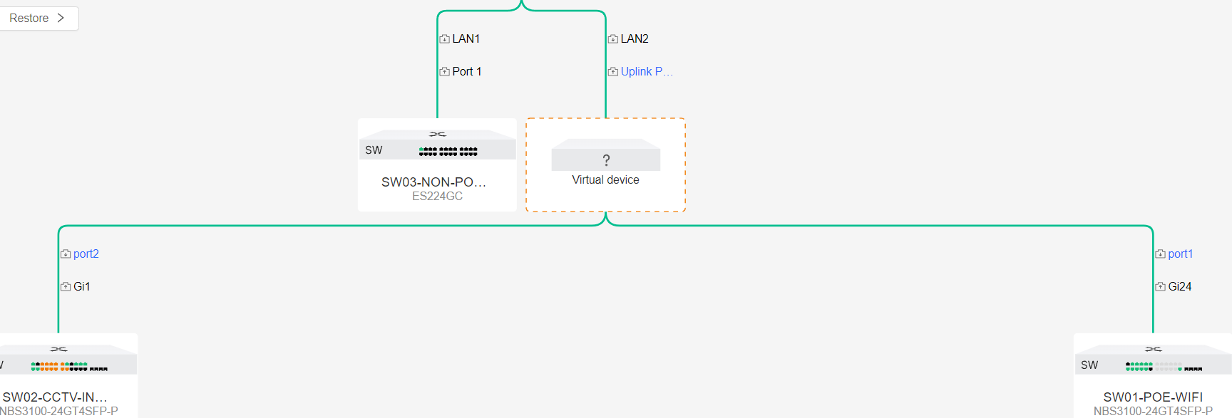

What can I do if the virtual devices are shown on the topology? Reply
GTAC-Henry
8916 2 2022-1-24 15:06:33
a)  The device is not on the Ruijie Cloud or is offline.
b)  The device is not the Ruijie device.
c)  If the device is an unmanaged switch, it is recommended to edit the name and the port manually.
d)  If the problem is still unsolvable, you may start a Live Chat with our Support Engineer for assistance: Ruijie Support
0 2024-6-27 12:53:46 View all replies
How to remove Virtual device?
0 2024-6-27 13:09:45 View all replies
NosSon replied at 2024-6-27 12:53
Hi sir,
Sorry it cannot support remove Virtual device.
Steve
