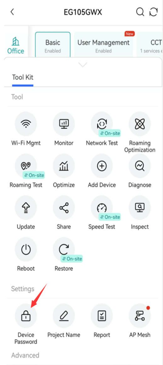

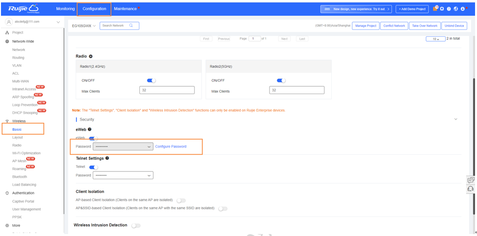

a) If you manage your Reyee device on Ruijie Cloud, you can modify the password through Ruijie Cloud.
Modify the web password through cloud web:
Modify the web password through the cloud app:
