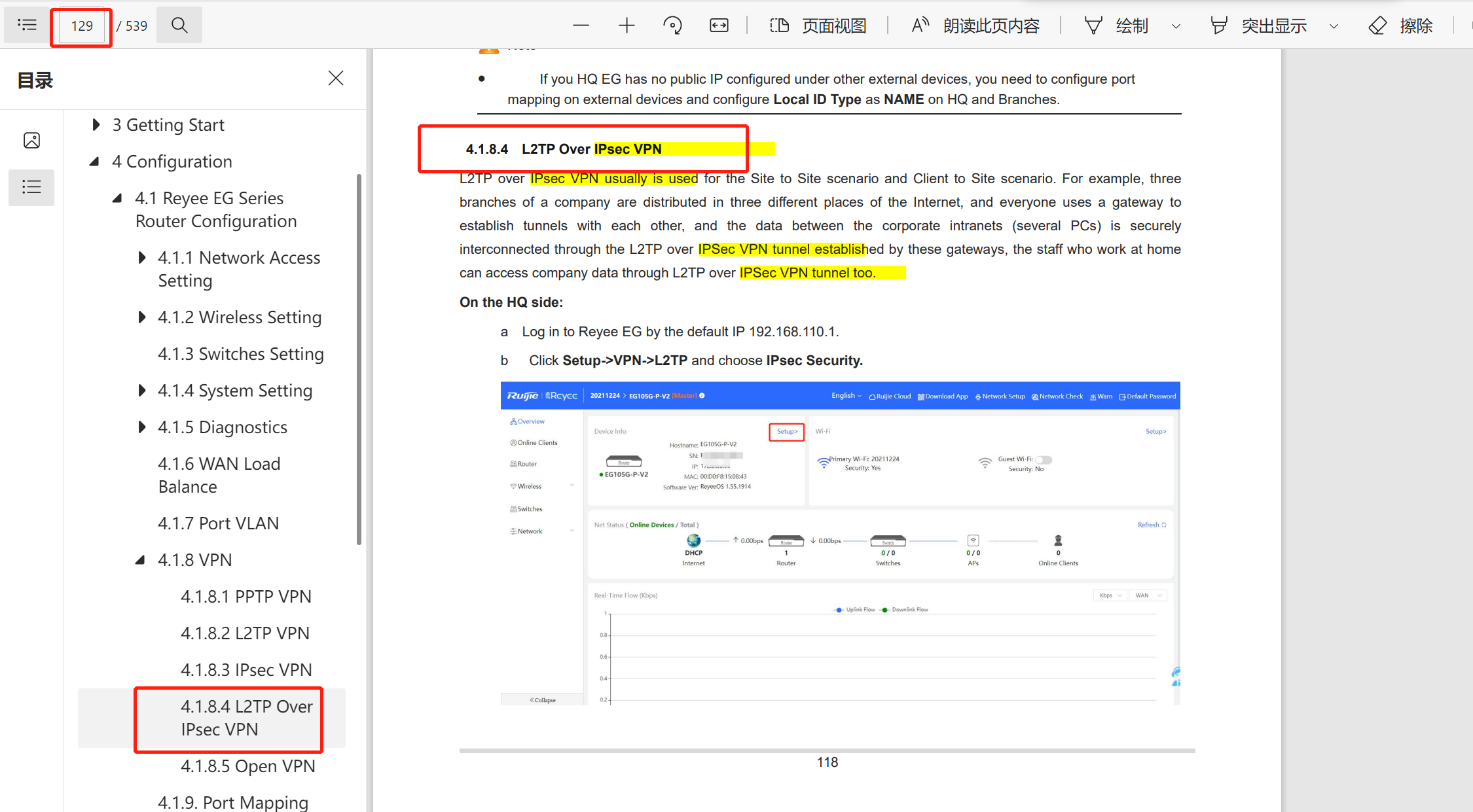

Could you please increase some quality of demonstrate pictures? because it's not cleary and blur
0 2022-7-27 09:52:25 View all replies
WittawatVonghangool replied at 2022-7-26 21:16
     Sorry for the inconvenience to your reading. You also can check the full content of this post in the 118 page of Reyee Series Implementation Cookbook V1.0 - Wireless - ruijienetworks. The picture in the Cookbook is more clearly.
