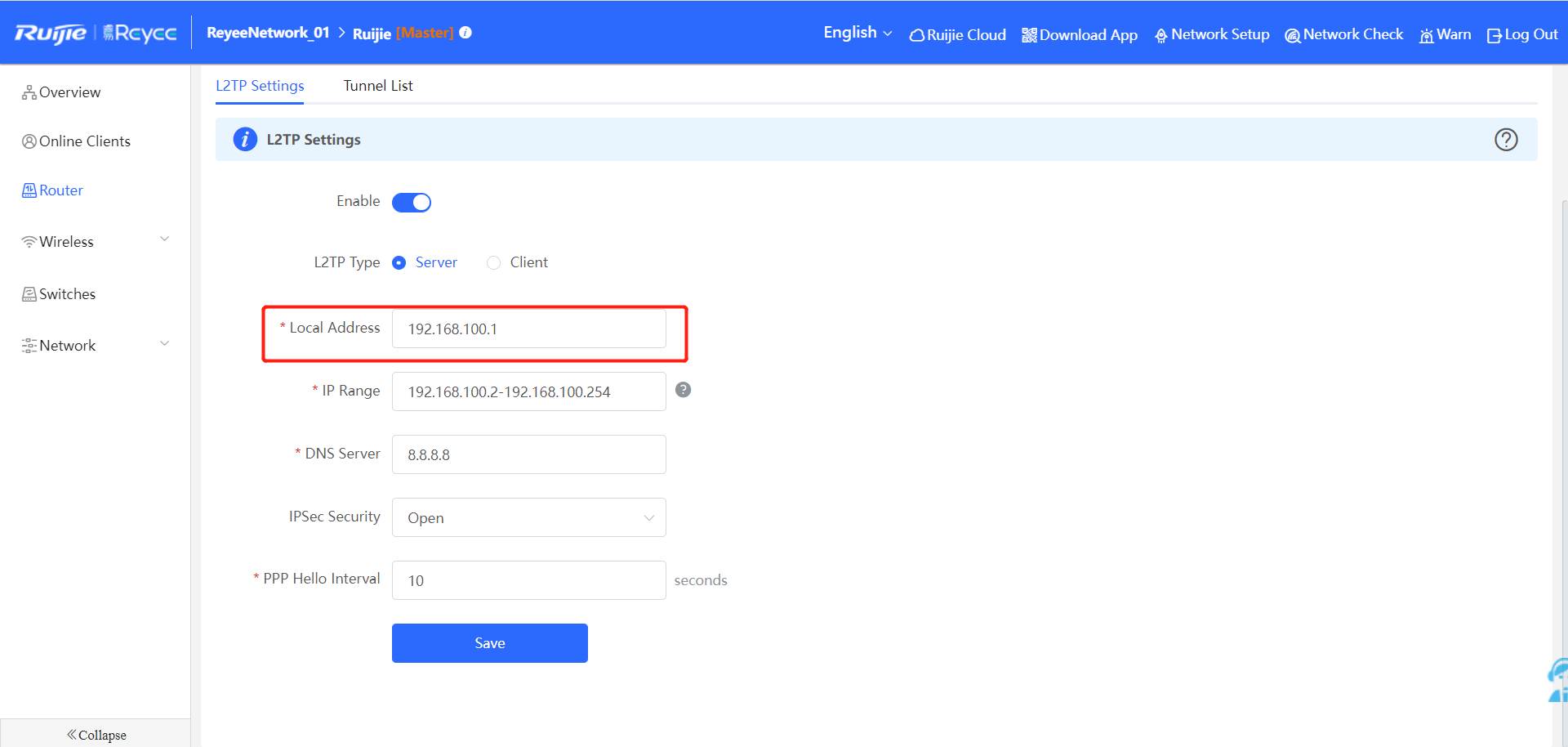

For example:
If your PC can’t reach HQ internal devices (192.168.10.0/24) afterVPN connected. Add the following static route on your PC. The 192.168.100.2 isthe PC‘s IP get from HQ.

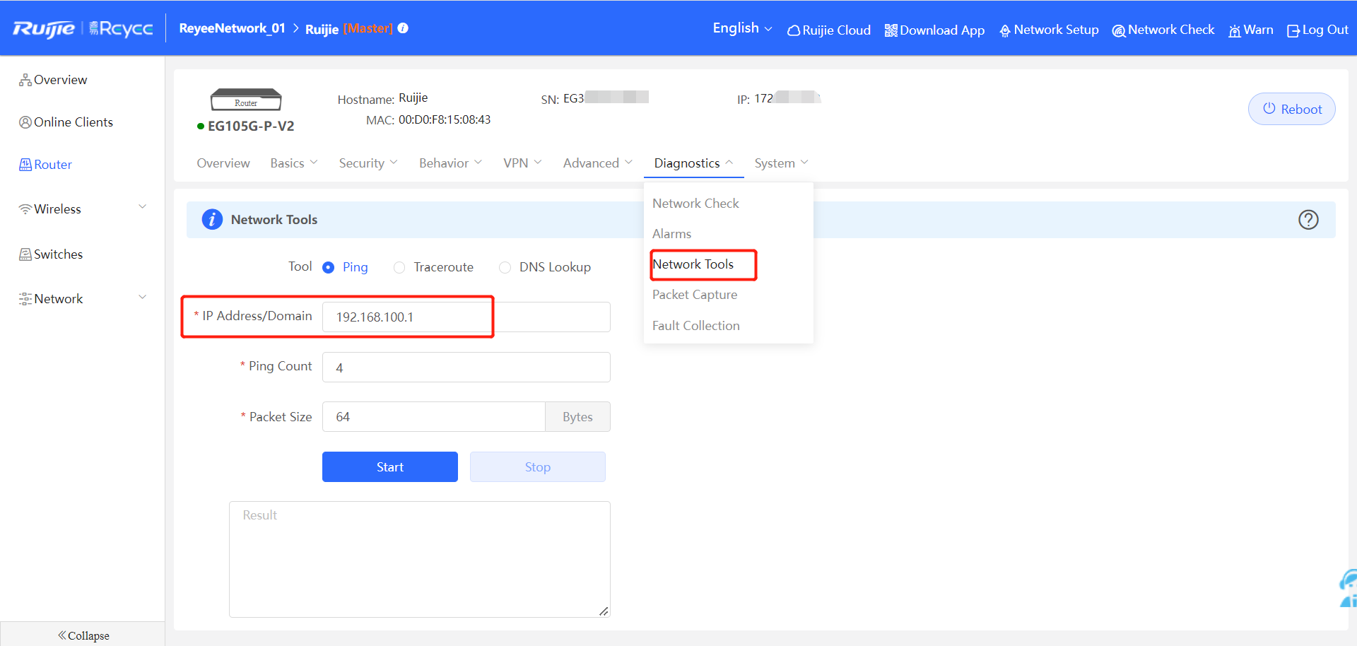

(3)   If you can reach the local IP setting on EG, but can’t reach internal devices IP, try to ping HQ internal devices IP on EG.
(4)   If you can’t reach on EG either, check whether firewall on that server is enable.
