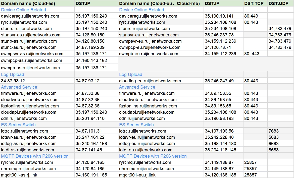

3)  Following ports are used for Ruijie Cloud management. Ensure these ports are available and the data stream is permitted.

1)  In order to provide smooth access and reduce Internet latency for users in Ruijie Cloud solution. There is 2 Ruijie Cloud hosting installed for global service. The dynamic hosting selection for regions or countries shows as below:
2)  As 2 hosting databases are isolated, if the serial number you input on and the device DNS resolution is not the same hosting, the device will not show online. First, verify which hosting you are accessing in the browser. Simply login your Ruijie Cloud account, and check the URL link.Cloud-as represents Asia cloud and cloud-eu is Europe Cloud. Then, login device's cli and execute ping cloud.ruijienetworks.com and check which IP address is resolved.(Asia-35.197.150.240,Europe-35.234.108.108). Please confirm the cloud hosting you are accessing is the same as the one device registered.
