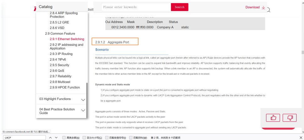

Does RG-S2910-24GT4XS-UP-H(V3.0) support LACP?
4785 1 2022-2-24 21:34:20
Yes, it supports LACP. You can configure LACP on the switch following this guide:
Ruijie RG-Switch Implementation Cookbook (V1.2)
RG-S2910-H Series
Configuration Switch
0 2022-2-26 21:01:16 View all replies
ryderbellamy12@ replied at 2022-2-26 12:28
LACP typically applies to strategies that bundle individual links of Ethernet connections, and not w ...
Yes, When there are multiple redundant links on the switch, and it is desired to perform a bundle aggregation with the peer network device, such as aggregation of the links interconnected with the core switch, or in the dual-core and multi-core ring network networking mode, this feature can improve the bandwidth of the link between them, and at the same time provide the effect of link redundancy, avoiding single point failure of the link and large-scale network interruption affecting key nodes
