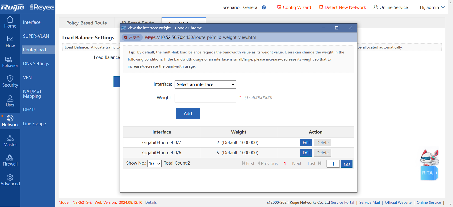

3) Customize interface weight to ensure that traffic goes through the different egress according to weight.

5) Configure the interface weight for two link

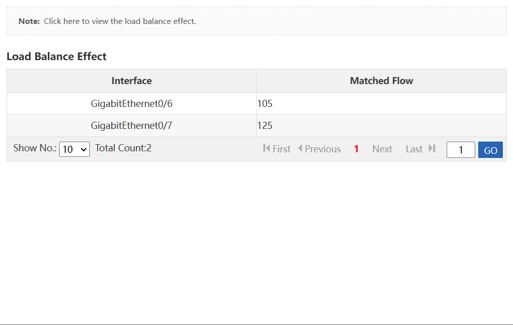

Configuration Verfication

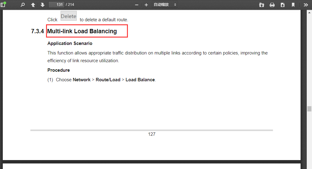

you can also refer to the WAN load balancing configuration via this link for NBR:
https://reyee.ruijie.com/en-global/resources/preview/reyee-rg-nbr-series-routers-web-based-configuration-guide

Dear Support,
I would like to know that if I weight the link more than the data or internet usage, it will run in and out of the link with the highest weight, for example, ISP1 = 2, ISP2 = 5, it will run on the ISP2 line, right?
And
If I set it like this and find that it still runs on ISP1, what should I do? And if we set the weight equal, what principle is used to select it?

Dear customer
yes

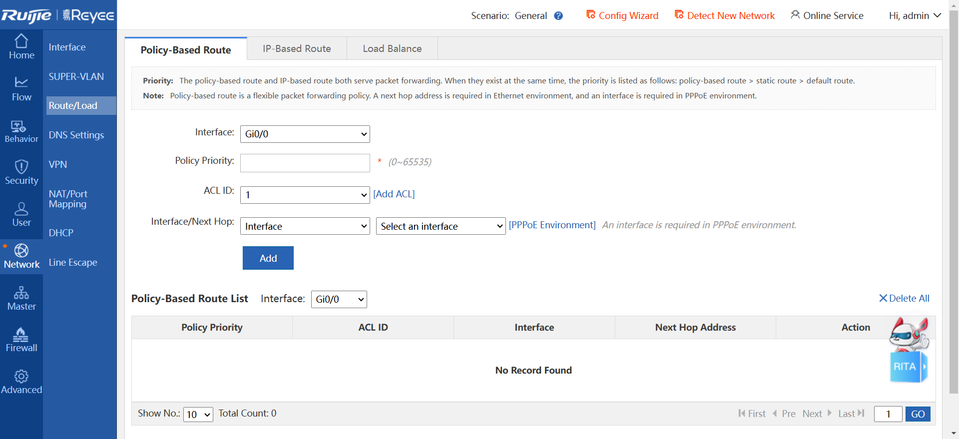

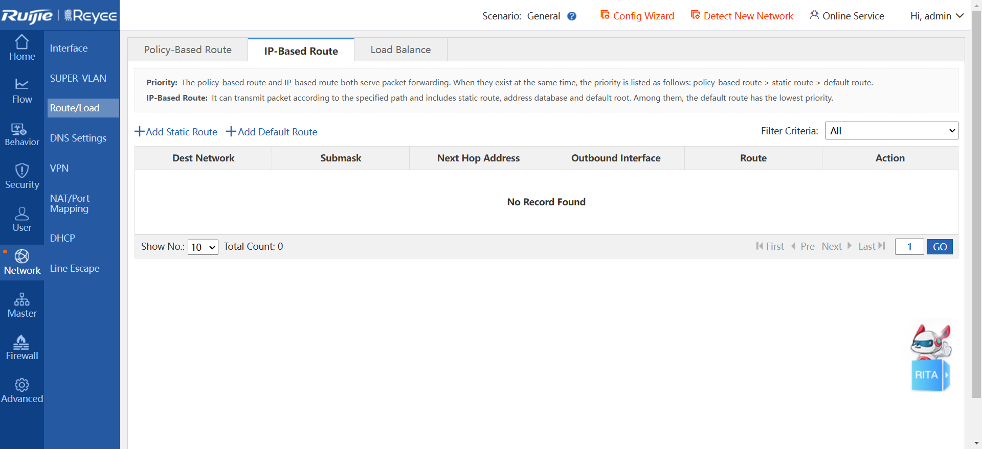

For this situation, you can check the PBR and default route config.
If the bandwidth usage of a certain interface in the environment is always low, you can increase the weight of the interface to improve its bandwidth usage. On the contrary, if the bandwidth usage is always high, you can reduce the weight of the interface. You need to change the weight.

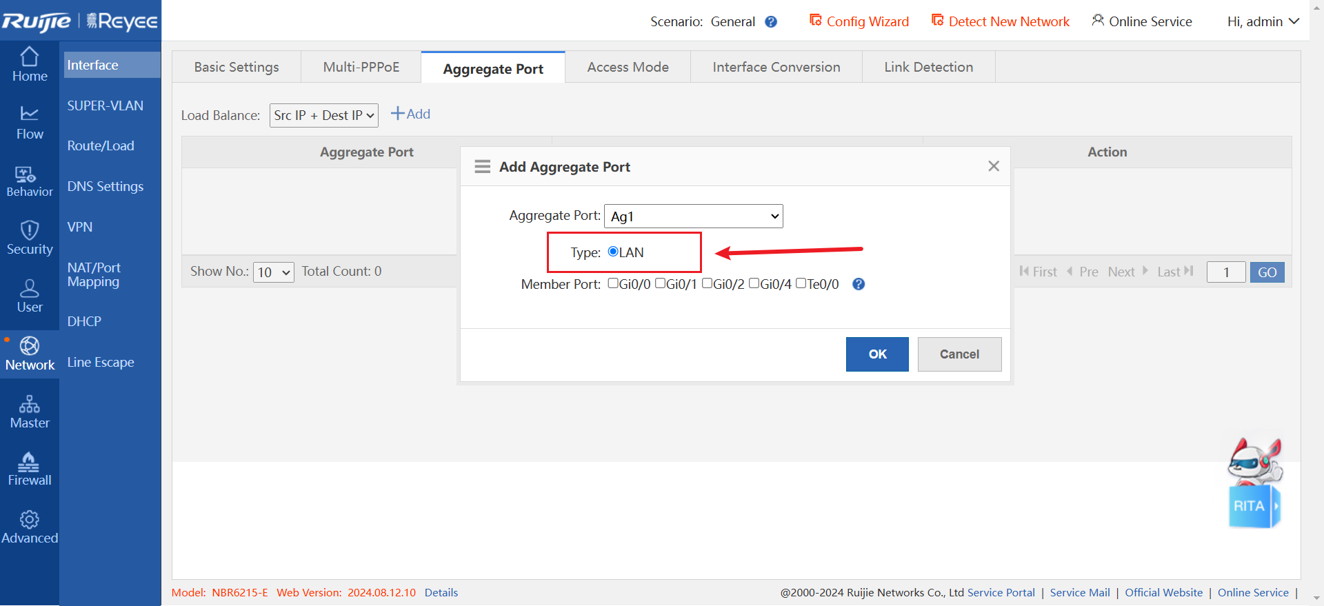

Another question, can NBR combine Link Load balancing? For example, I have ISP1 = 1G and ISP2 = 1G, which command should I use to combine the Bnadwidth to 2G?
Only link aggregation can achieve your function. Currently only LAN ports support link aggregation.
