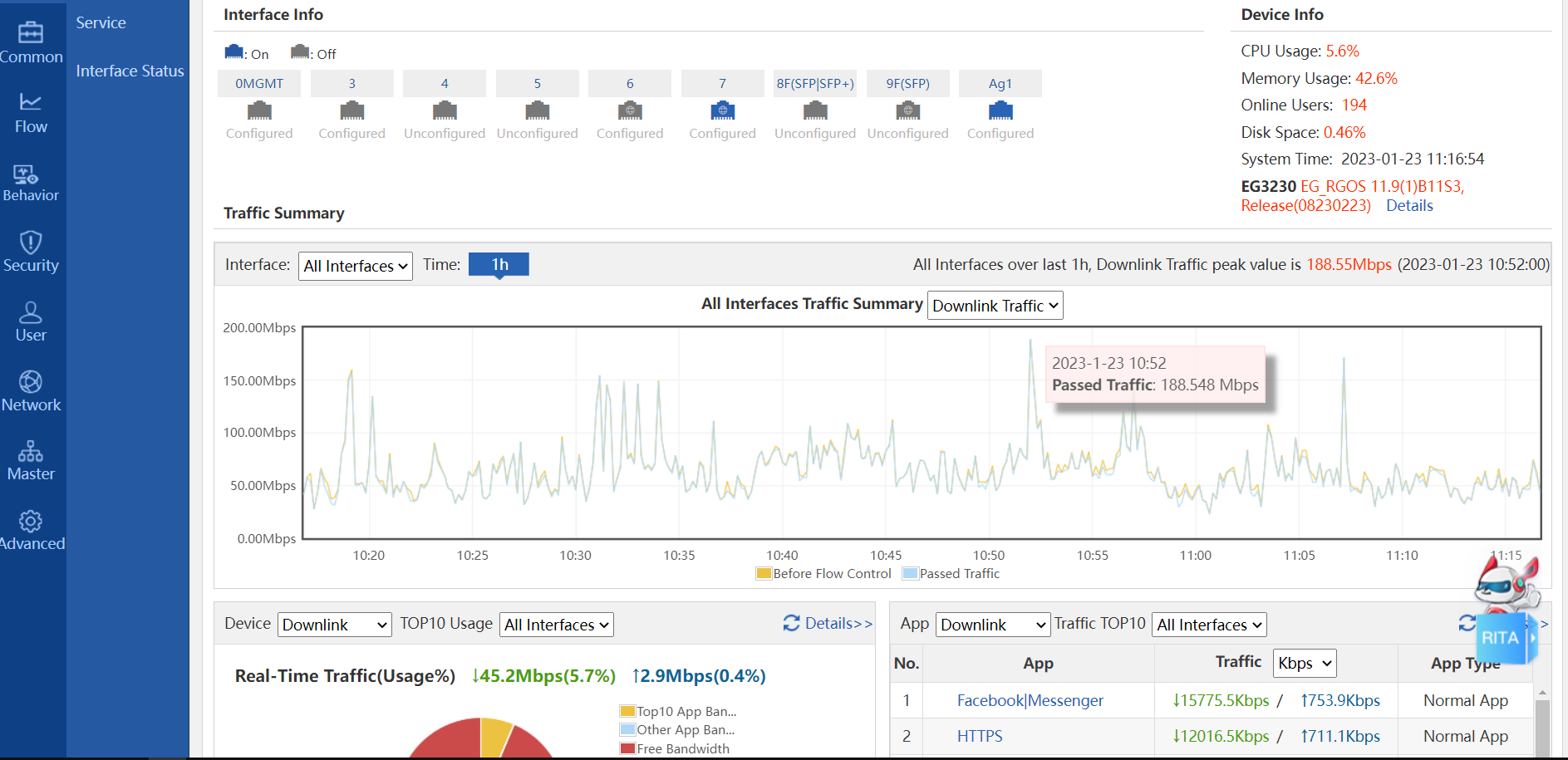

Hi. My ISP is providing me at 600Mbps stable. However, I'm only getting 100-150Mbps on the EG3230 with Flow Policy disabled.
All cables are checked, CAT6 cables.
What to configure and/or what to check?

I'm reupping this question since it is still my problem until now.
My ISP is providing me 800Mbps max, at 650Mbps stable. However, My EG3230 is only reaching 180+Mbps, barely reaching 200Mbps.
I have tried disconnecting all users, except in the Mgmt port of EG3230 to test the speed, however I'm still getting the same speed.
Whenever I test my speed directly from the ISP, yes, I'm getting 650-800Mbps.
I am really having a hard time with EG32.
