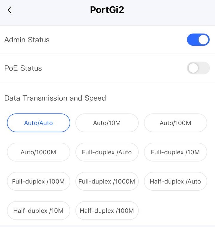

hii, if I turn off the POE, does that mean I can use that port like a regular switch without power? if yes, I will connect that port to another switch.
this is the screenshot that I turned off the POE on one of the ports of a switch:
