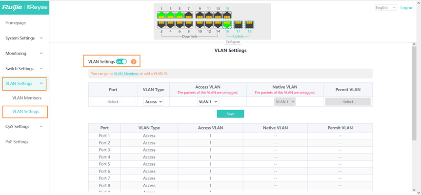

ES0 series and ES1 series are Unmanaged switches that cannot be configured, plug and play, and do not have VLAN&TRUNK. However, these switches are transparent to all vlan labels. That is, they can transmit data of all vlans. Professionally, all interfaces on the switch are trunk.
For the L2 RG-ES200 Series, you can configure the trunk as follows:
RG-ES05G
Configuration Switch
