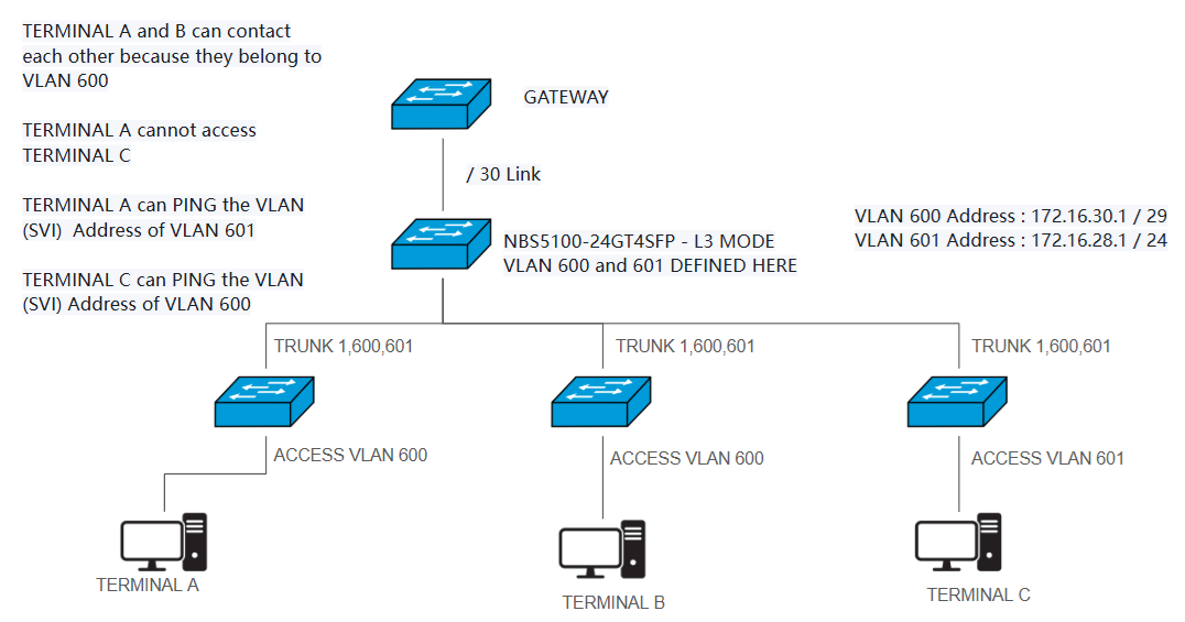

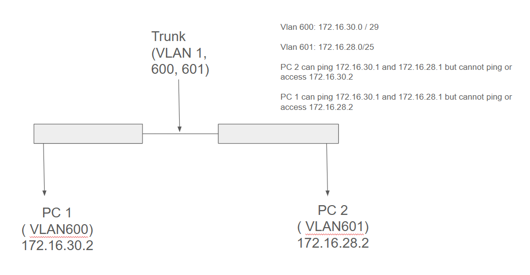

Hi,
I have created two vlans (600 and 601). Clients of VLAN 600 has static IP address, Clients of VLAN 601 are DHCP assigned.
I want clients in both VLAN to communicate with each other.
From any of the two VLANs I can ping the VLAN addresses 172.16.30.1 and 172.16.28.1 but the clients cannot be accessed.
On the switch side

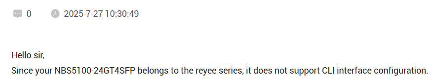

That would be a great solution but the switch does not support CLI Configuration as confirmed in one of my other posts:
0 2025-8-19 08:55:43 View all replies
Kurt Salvador replied at 2025-8-19 08:44
That would be a great solution but the switch does not support CLI Configuration as confirmed in o ...

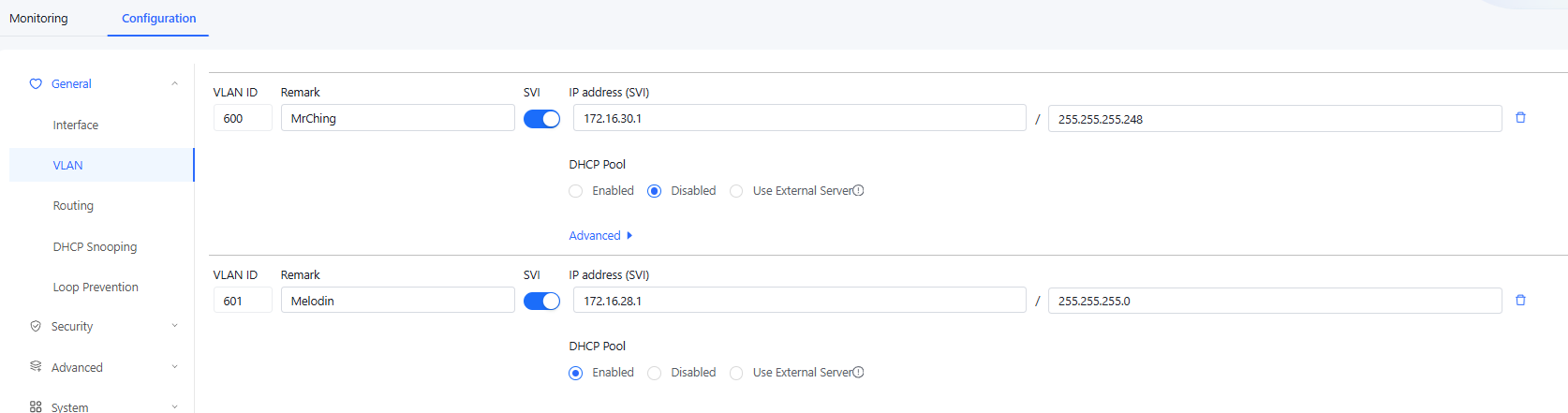

All terminals in VLAN 600 and VLAN 601 can
a. Surf the Internet; and
b. Ping the SVI addresses of each other
For a more detailed setup see below. Thank you in advance for the help.

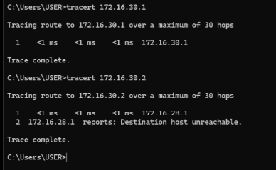

And this is a tracert check:
172.16.30.1 is the address of VLAN 600
172.16.30.2 is the address of a Terminal connected to the VLAN600
