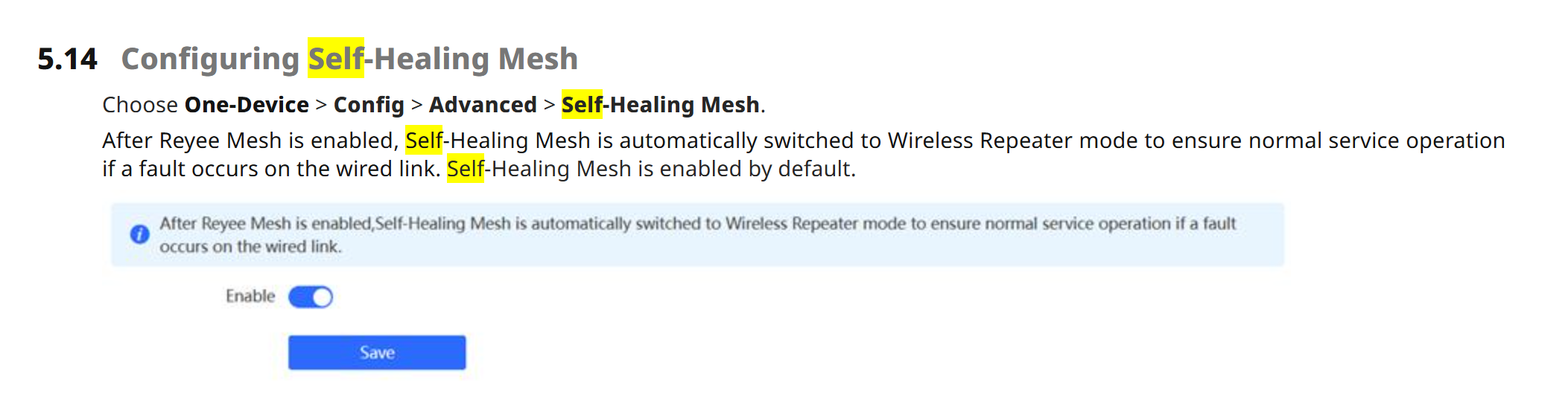

hello sir,
The mesh may not be able to connect normally due to power outages or device restarts. It is recommended that you enable this function on your device to increase the possibility of self-recovery after the mesh connection is disconnected.
