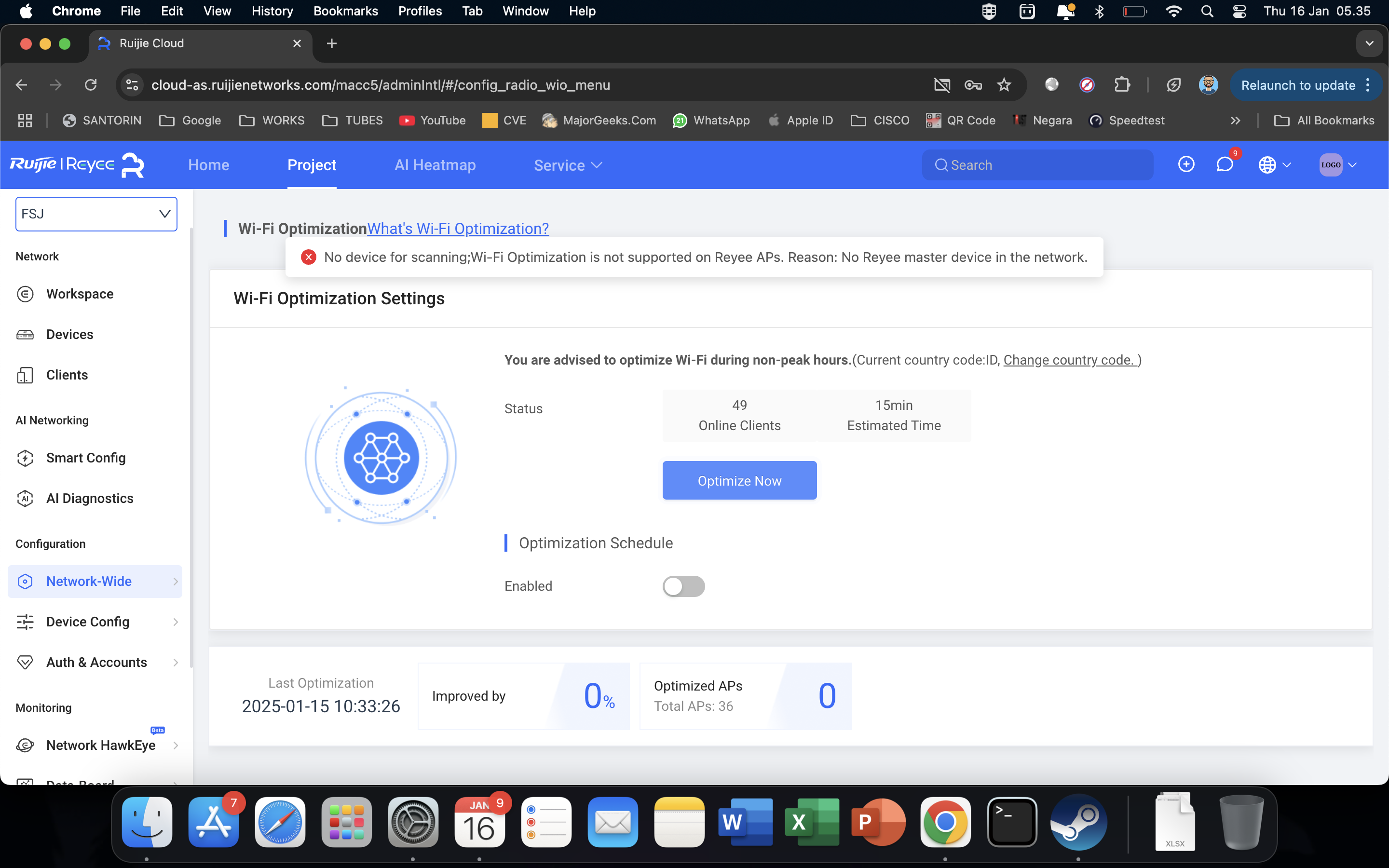

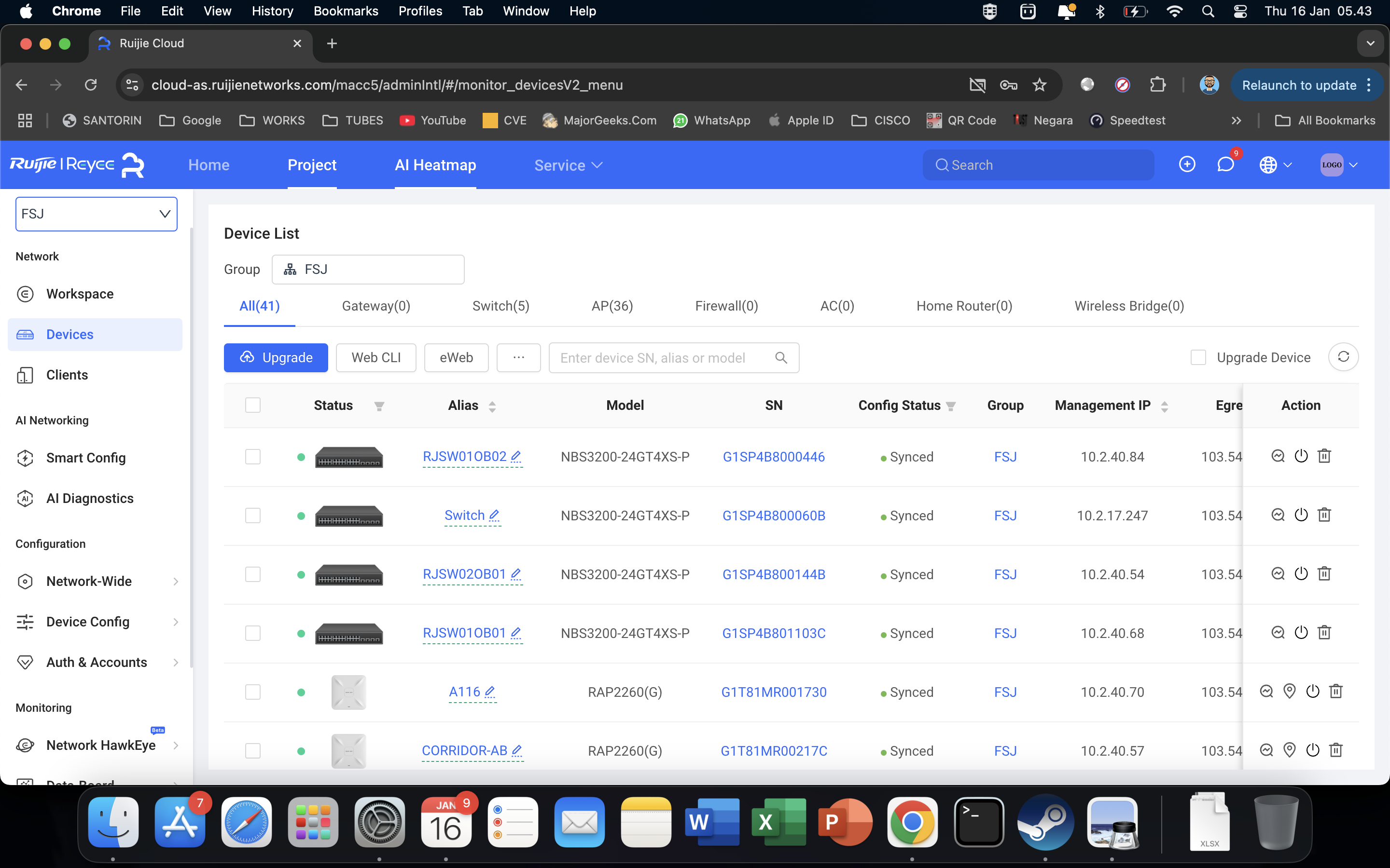

Hello,
We have 34 AP RAP2260(G) connected with 3 switches (NBS3200-24GT4XS-P) in each area. We are not able to do the WiFi optimization from the cloud, and always get this message; "No device for scanning; Wi-Fi Optimization is not supported on Reyee APs. Reason: No Reyee master device in the network".
However, if we click on the device registered in the cloud, there are 3 devices that act as the master.
What is the issue here?
Thanks.

Thanks for your reply.
I tried the link for RITA, but got this message "[color=rgba(0, 0, 0, 0.85)]RITA cannot answer this question yet
". For the IP address, each AP got an IP address from our DHCP server.
This is what it looks like when I tried WiFi optimization
As you can see, the AP already has IP addresses.

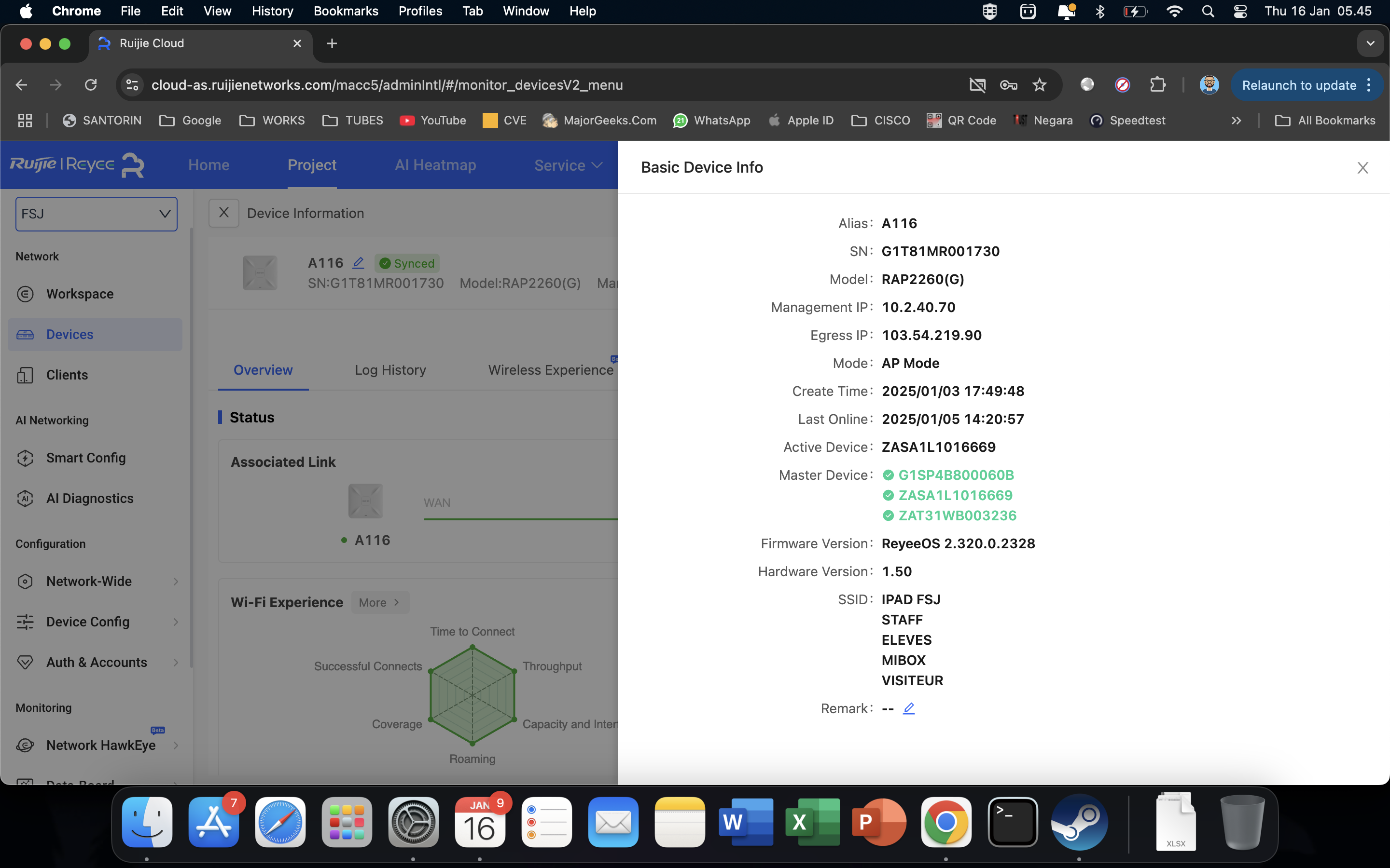

If I click on one of the devices, it says that our network has three masters
