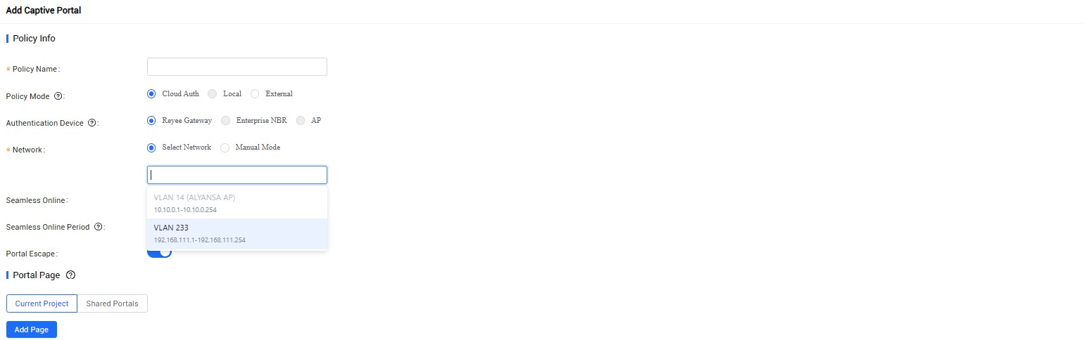

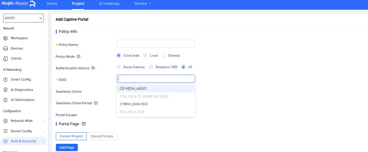

The Dynamic Vlan is not working on my 2nd Ruijie EG105GW-X but it is working on my 1st device
2132 1 2025-8-30 07:05:10
I noticed an inconsistency between two identical devices (Ruijie EG105GW-X). On my first unit, the Captive Portal does not support VLAN configuration, while on my second unit, VLAN settings are allowed within the Captive Portal.
in my 1st device i can assign the captive portal policy to dynamic vlan
In my 2nd device, it can only route the captive portal to SSID (Wifi Network) only.

Dear,
Could you pls help me confirm what devices are available on both projects?
What is the firmware version of both EG devices?
