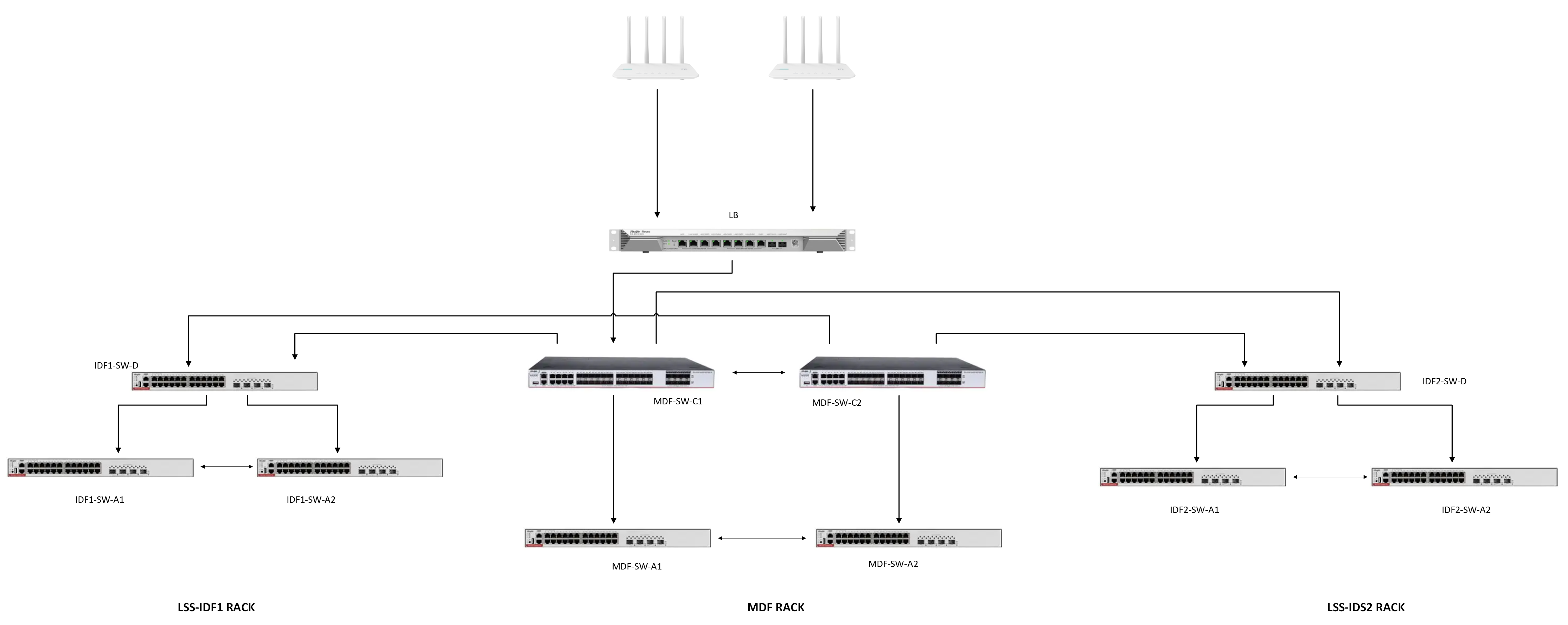

Thank you very much for your consultation, sir. If it is convenient, could you provide me with the complete topology information of this project?

Thank you very much for your prompt reply. Sir, could you provide me with a simple topology of this project and point out the location of the DHCP server for this vlan1? If it is a DHCP server across three layers, we need to configure DHCP relay.

hi,
Ruijie LB have the dhcp pool.

Thank you for your reply, sir. If it is convenient, could you describe to me the specific location of the terminal that cannot obtain the vlan1 address in the topology? And can you point out the location of the vlan1 DHCP server for me?
