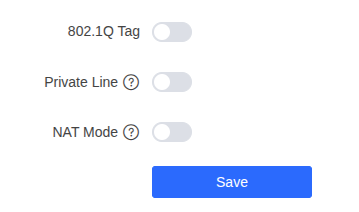

Good Day,
I have a Reyee RG-EG210G-P router, which has 2 LAN networks setup on it and port VLAN is setup of each LAN network on different ports.
192.168.110.0/24 (VLAN1) is on LAN port 0 , 102.20.59.x/29 (public network) on LAN port 1. When i switch NAT mode off under the WAN port of the router, the 102.20.59.x/29 (public network) works and i have internet when connected to that port.
When i connect to LAN port 0, 192.168.110.0/24 (and get DHCP IP) i do not get internet unless i switch on NAT mode on the WAN port.
Is there a way to specify which LAN use NAT via the PPPOE account on the WAN port?
With a Mikrotik you can setup multiple NAT rules but i have not found any on the Reyee routers.
What im trying to achieve is when i connect a device on LAN port 1 (public network), and setup a static IP within that 102.20.59.x/29 network, i am able to browse to" whats my IP address" and it should show the public IP i setup on the device connected to LAN port 1. Which works with NAT mode turned OFF.
But like i said then it breaks the internet for the private IP 192.168.110.0/24 as it needs the NAT Mode switch on.

Hello,
--- I am sorry that current our reyee device does not support this.
