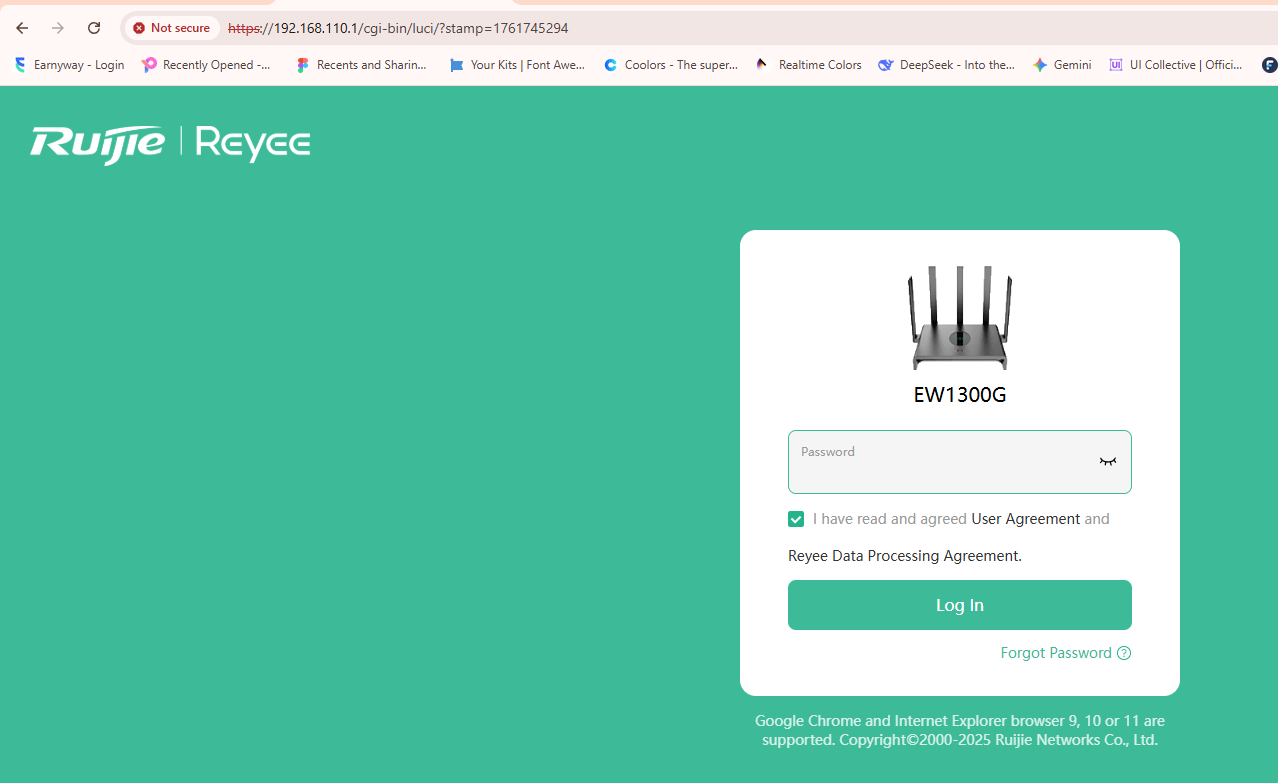

After update new firmware , bowser shows not secure.. Password not saved in google password manager.. i give a picture to show this problem.. Why this happen & what is the solution?

Sir, first of all, let me confirm with you. Can you access eweb normally by ignoring this warning? If not, you can take a screenshot of the login failure interface and share your project. If it's possible, when you access the router management interface via https://192.168.110.1, if the browser shows a warning like "connection not secure" or similar, this is an expected normal phenomenon and does not mean that your device or network has a security threat. The "unsafe" warning issued by the browser is its standard response to "unverified certificates" and not a judgment of the danger of your network environment. Under the premise of ensuring that you are connected through a trusted local network, continuing the access is a standard and safe operation.
